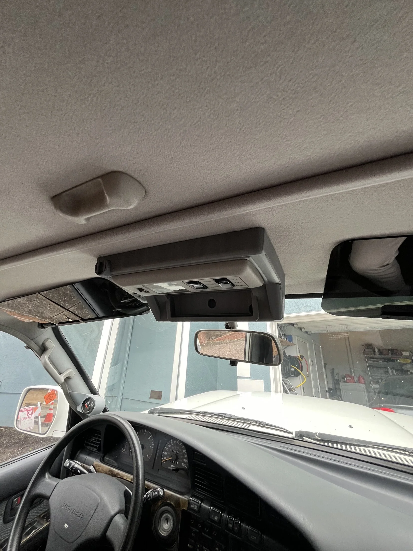

I've been working on a design for a custom overhead console, inspired by the consoles that came on the JDM 80s that hold the aux fuel gauge and altimeter.
I recently bought a GMRS radio and wanted a home for it (this one), but it needed to be somewhere easily accessible, and figured the overhead console would be the perfect place for it.
My design is using the 2 existing bolts that hold the original dome light cover in place, and as long as you don't plan on putting something heavy up there, that will be more than enough to secure everything. If you do put something heavier in there, there are 2 additional holes on the roof towards the front (or back of the console) that can be used, but my design doesn't have those holes so they will need to be measured and added. I am using this on a 1994, but I'm pretty sure it will work on any year 80 Land Cruiser.

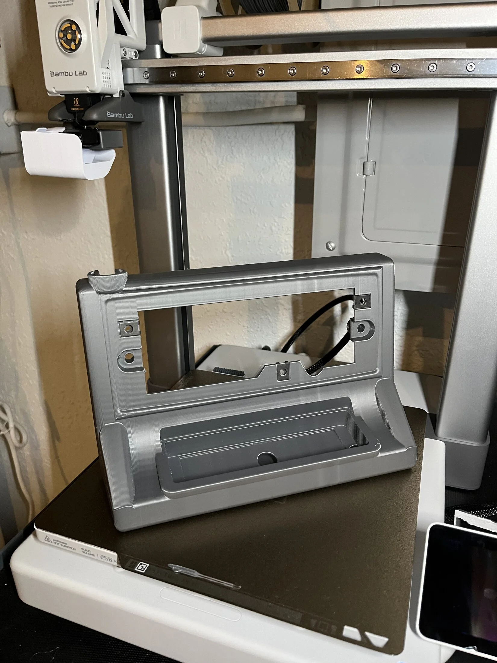

If you decide to put the same radio I have in there, its a perfect fit and the only modification you need to make to the print is drilling the 4 holes that hold the radio display mount in place.

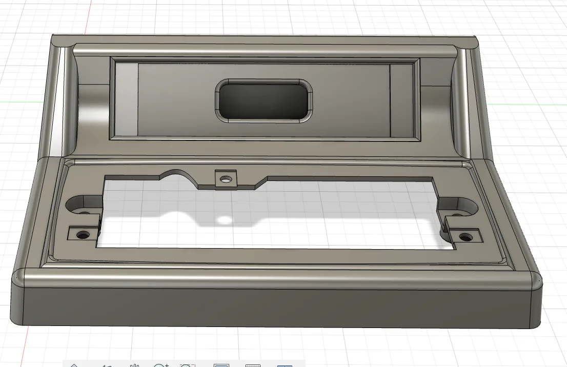

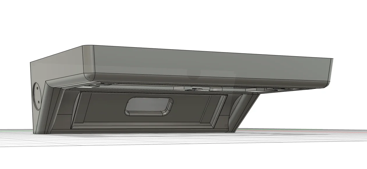

I've included the STL file so if you want to use the original print you can easily load it into a slicing software. The CAD files are there too which you can use to modify the console and re-design it to your needs.
Finally, the CAD files have all the different objects that make up the console, so you have full control over how you want to mix and match the console to fit anything up there. The most important objects in the file are the mounting plate that line up with the 2 holes, which is also used to hold the dome light/switches panel in place and the cover that goes over them, as well as the base console body.

View attachment 3752451View attachment 3752452
