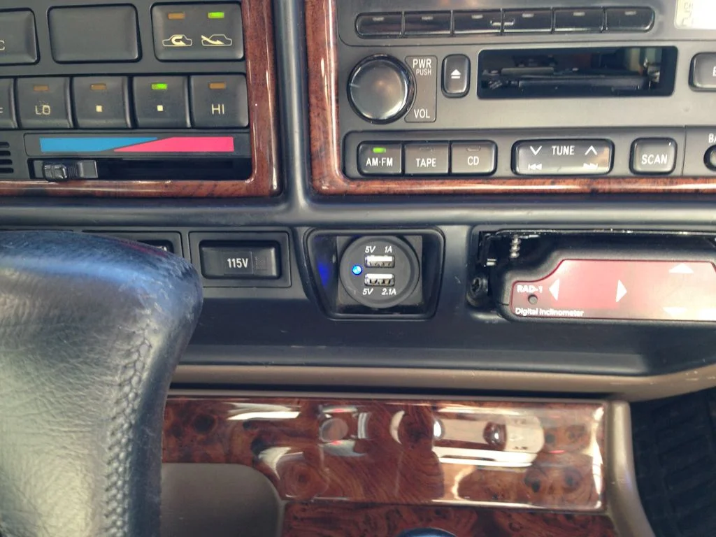

I have this one instead of lighter in Marilu dash ..
http://www.amazon.com/gp/product/B00IRJH8CE?tag=ihco-20
I have one of those in my rear compartment.

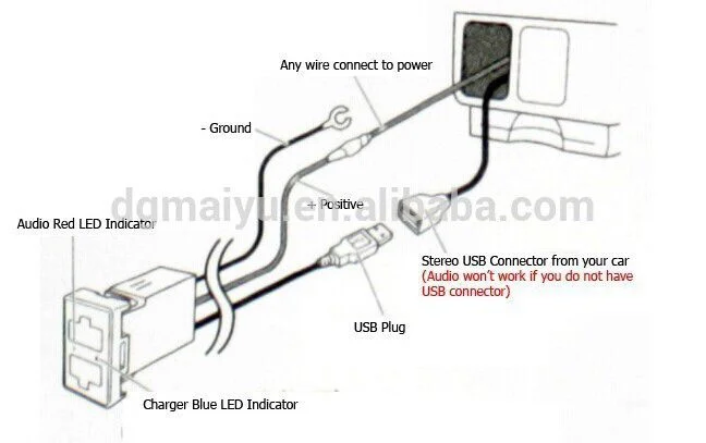

What I am looking for is a dual port USB plug that fits in a factory slot where one port is solely used for charging and the other port is an extension of the input into a head unit that creates a nice finished look instead of having wires routing all over the place. If you look at the picture I attached above you can kind of see what I'm talking about. Two wires (+ and -) and a USB extension hookup.
Here is another picture of the sort of dual port i am looking for as far as how I want to wire it.

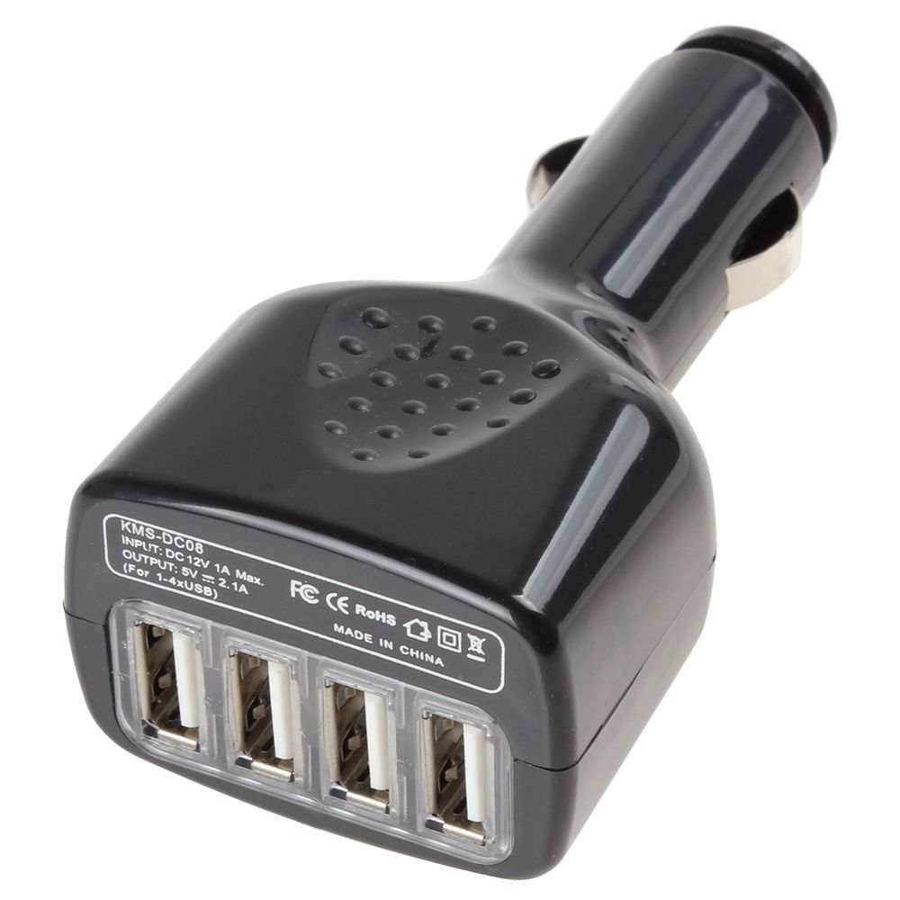

I cant find a pic of the original quad port, but this one is similar. I gutted all the bits out of the body, cut a hole in the original blanking plate then epoxied it on. There is a surprising amount of room behind the dash at that position
Hi ... thanks for the explanation ... I'm going to have to ask a friend for help ... I'm not good at doing electrical work !!

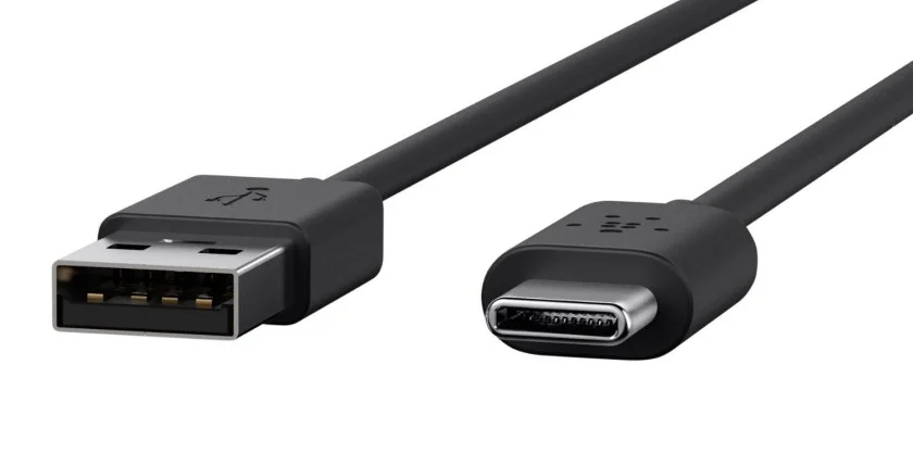

This is all great except that a lot of newer devices are converting to usb c.
USB-C is awesome and I only buy phones, tables etc that have them. The other end of the charging cable however is still just the normal USB plug so it will still work just fine on the charging setups listed here.
