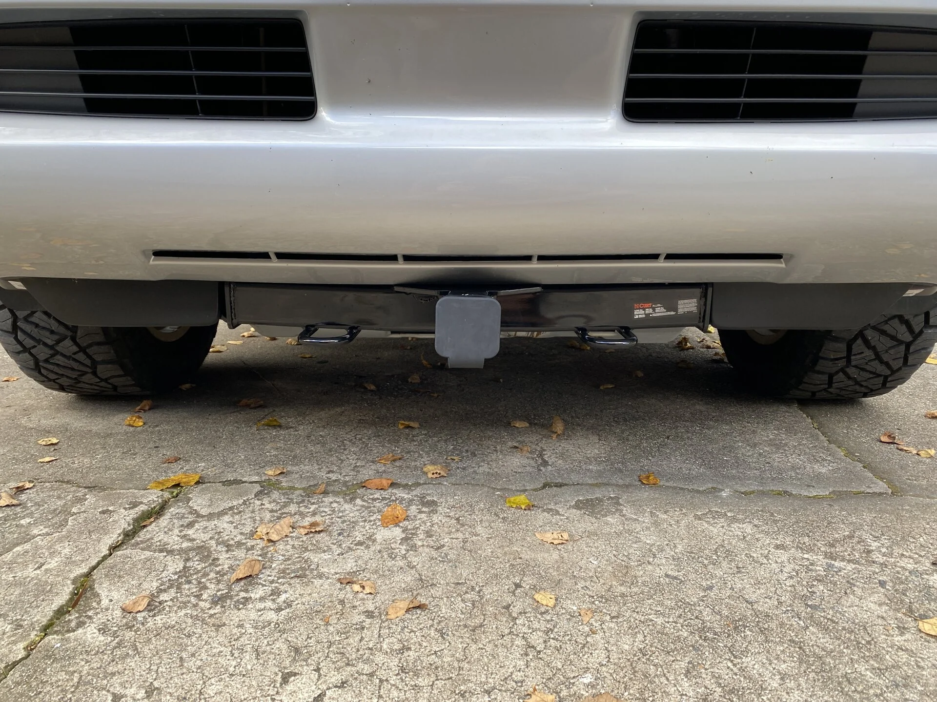

Wanting to add a front receiver hitch--does anyone have experience with the CURT 31076? Its application is for a 4Runner... wondering if it will work on a 2011 GX?
Ever have any luck with this?Wanting to add a front receiver hitch--does anyone have experience with the CURT 31076? Its application is for a 4Runner... wondering if it will work on a 2011 GX?

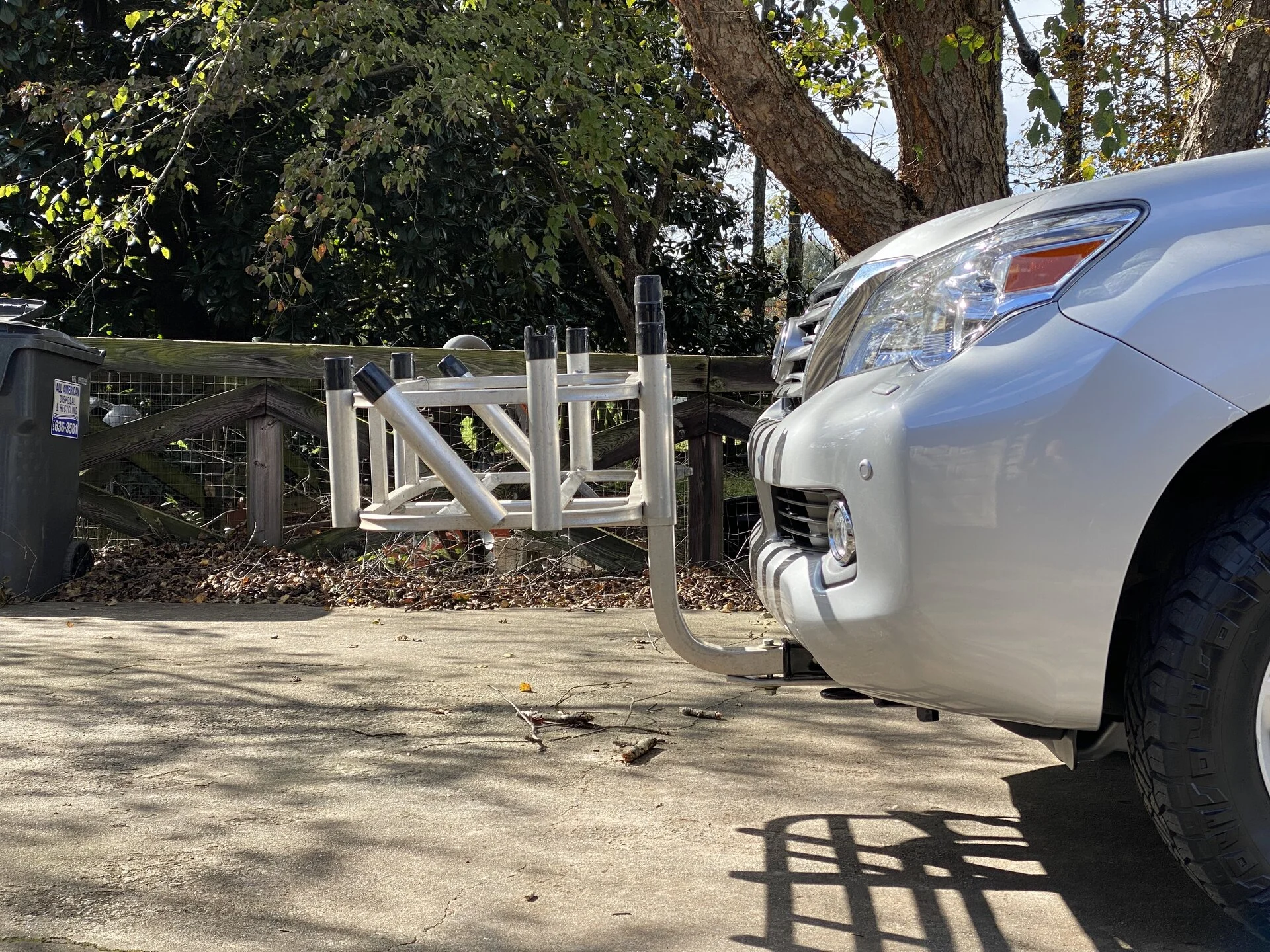

Right on! Thanks!It worked out outstandingly well! I split/moved the little air deflectors over and it looks great - tucked up out of the way great and is a good lift point.
View attachment 3434431View attachment 3434432 well!!
Now you can get a hitch mounted winch and be able to use it front or rear!It worked out outstandingly well! I split/moved the little air deflectors over and it looks great - tucked up out of the way great and is a good lift point.
