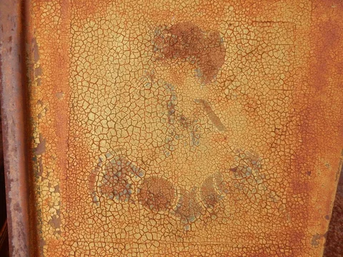

so while we on chev blitz... got this among my junk.
this the earlier varient; known as the "monkey nose". you may notice from the pics of the more common varient posted above that the windscreen slopes forward; ie the top sticks further forward than the base. this was to stop the enemy seeing your windscreen flashes in the desert. it was a lesson learned from the earlier "monkey nose". mine is even more unusual in that it was 2WD. not so rare in other theatres of the war but rare in aust because they were never sent here. seems the only few that made it to our shores were the result of diverted shipping during the war. so interesting old truck all in all. is really all there apart from bonnet, front springs and one axle. springs will no doubt have been pinched to make a trailer; a search of the district will prob turn them up. went to an abandoned station with a view to pulling the septic tanks out of the ground for my own use but hiab wouldnt budge them so loaded this instead. (and an F1 cab!) no point driving around empty. this (chev 6) was laying on its side with no plugs, carb or dizzy. blew the bores out with air when i got home with a view to fill the bores with diesel before i unloaded it and sealed up this motor. grabbed a crankhandle for a laugh and couldnt believe she turned over!! seems with the narrow roof compared to the wide front guards she was just overcentre enough that water never got in the motor. all sealed up now of course. this one also interesting in that has old metal checkerplate floor of unusual pattern. one other has surfaced but most were wooden floor. Z number is on the doors and other insignia (i take to be an arm holding a battleaxe) is on left front beside the bonnet. i have not studied any of their significance.
