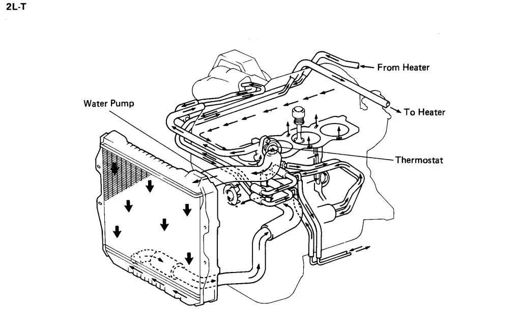

HI,
I have a 2LT marinized engine equipped with the CT20 turbo. I am after adding water cooling to the Turbo. I have found kits already online. However I wasn't able to find some pics where the pipes In/Out connect to the engine. Probably somewhere around the thermostat but need to see exact locations before buying anything.
Anyone has some photos willing to share please?
Tks!
Tks Jorge!

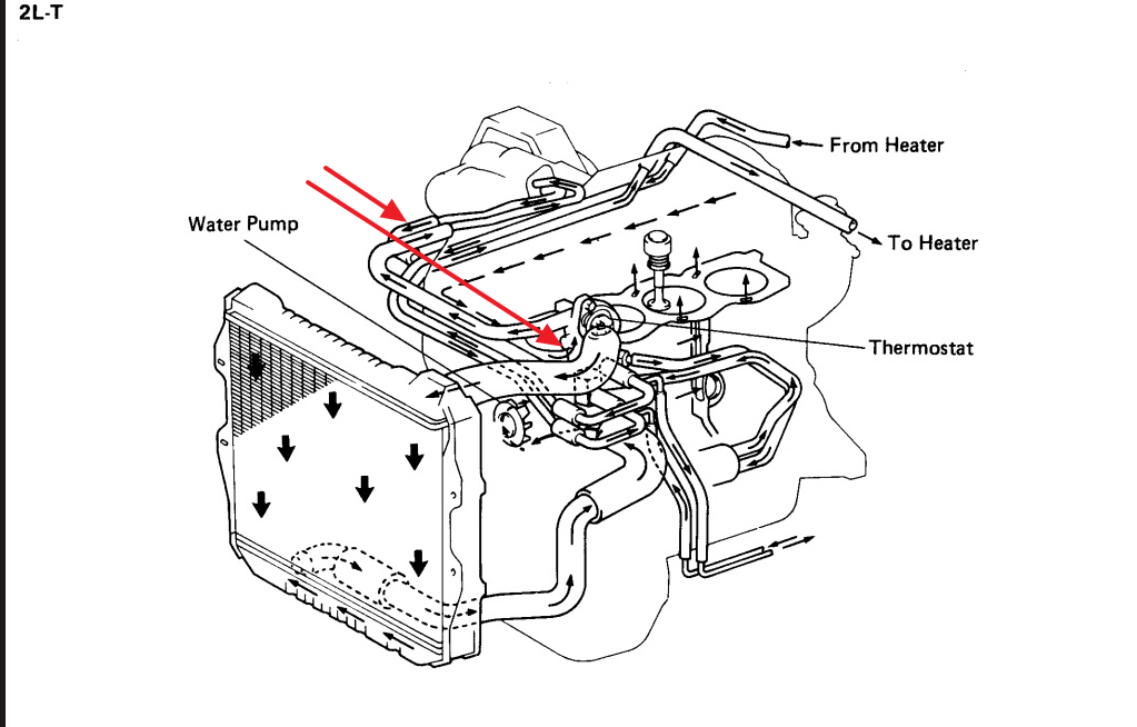

Am assuming that the return from Turbo is the one almost hidden as in arrow right?
Or I can probably use the Heater In/Out as mine are not used.
Tks Jorge!
Yes indeed. There is a hole there too, I think it could be use for an extra thermistor or fitting, I remember adding one thermistor for an electric fan.

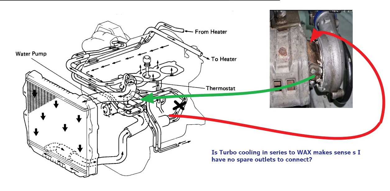

Replying on an old thread.
Was wondering if I can get the turbo cooling from the WAX outlet as shown. So water circulates to the WAX and passes to the Turbo and returns to the block as shown.
This will reduce as well extra connections. I do not have any spare/closed ports available.
Any suggestions please?

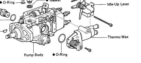

You can probably bypass the thermo wax completely and rub those houses directly to / from the turbo.
The Thermo wax is also known as an ACSD, Automatic Cold Start Device.
On other Toyota diesels, it's recommended to remove the ACSD as they are a failure point, and can destroy the fuel pump.
I'm guessing if you're playing with boats in Malta, you don't see harsh winters?
Hi ,
as you accurateky stated, the boat is used in waters between 20deg and 30 deg Celcius. So I will take your advice and unplug the pipes completely and connect Turbo cooling directly. I was always tempted to remove this unit but wasn't sure about its use.
