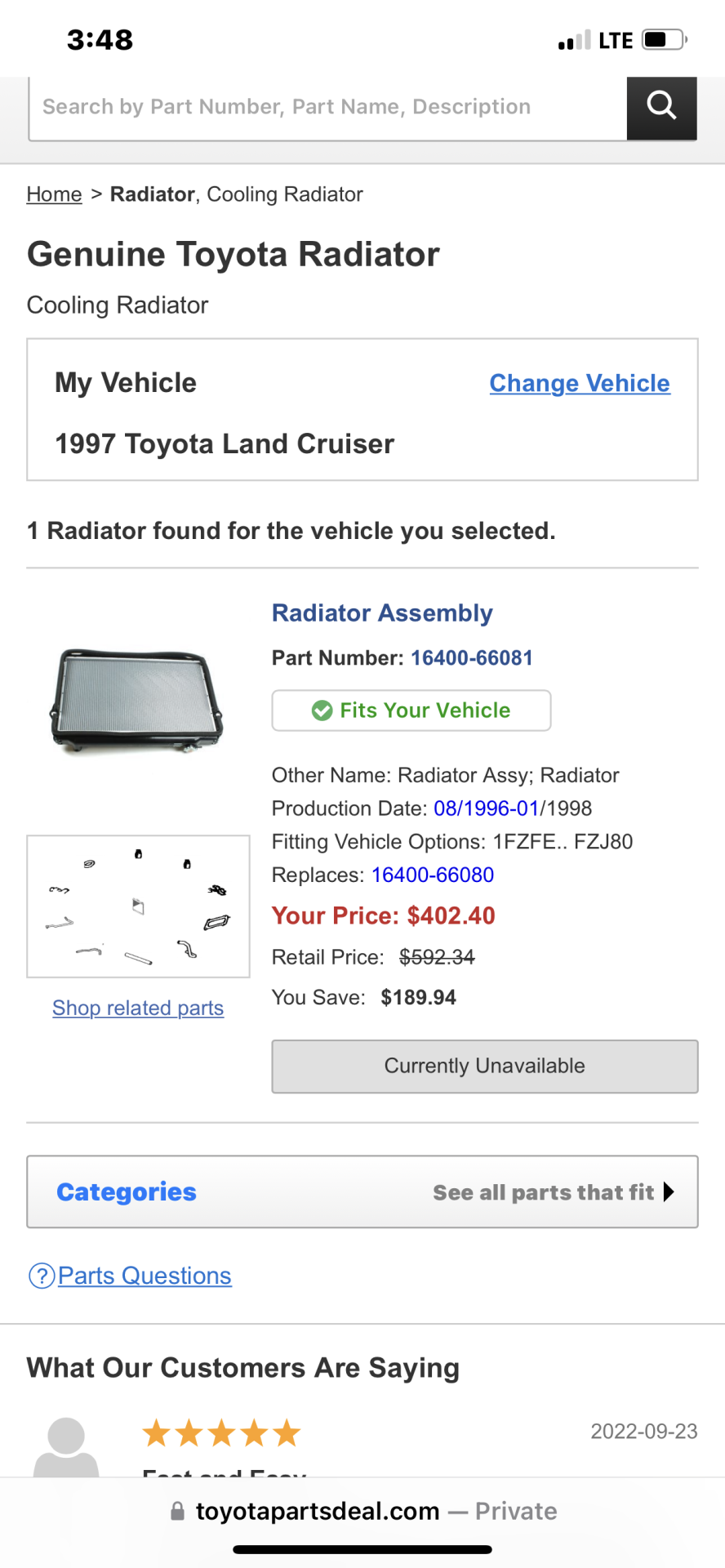

Is the issue about price for,the replacement radiator? I went with a TYC-1918 several years back when doing coolant system overhaul (*that turned into new OEM short-block,...), but the radiator has been exactly what I wanted for $280 shipped, and looks very close to Toyota OEM apart from the pre-installed foam strips, which are required to keep airflow going through the radiator and not around it.
The Ron Davis is a one-and-done solution, but well over $1k. I considered it, then the disposable nature of radiators where I live (AZ Sonoran desert).

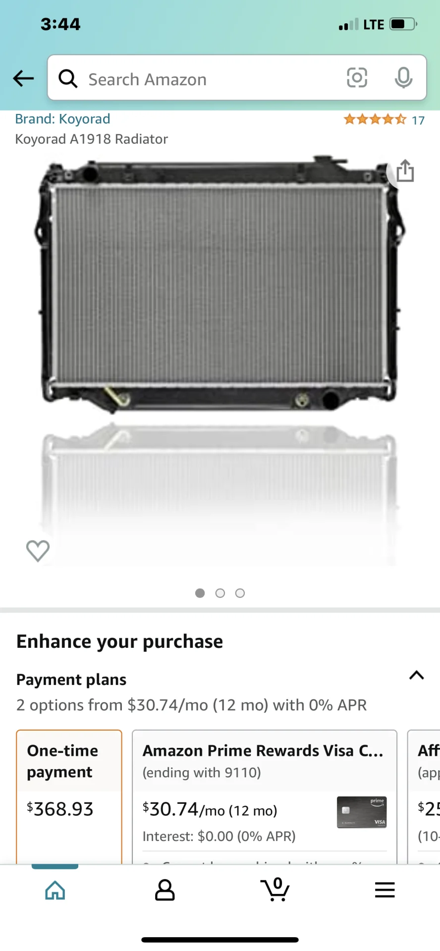

Koyorad 1918 $370 on Amazon bought 2 years ago and very happy with it.
I was waiting for someone to tell me this is my only option, thank you sir. Do you know where I could source the Ron D. Radiator from? Remember everyone, CSF = s***. well built, not well designed for what the truck requires.
Call Ron Davis. They are pricey, around $1,500 with a long lead time. If you can still get OEM , TYC or Koyo, I would go that route.
