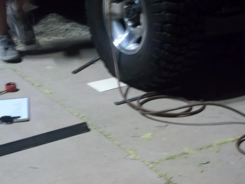

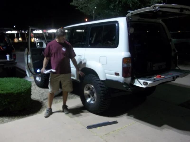

Prior to the run yesterday, LandcruiserPhil and I experimented with the air pressure in my tires. I'm running 33x12.50x15s, and was recommended to run them at 38psi by the installer.
Before leaving the meeting spot (Sprouts at 94th and Shea), we aired my tires down to 25psi on the driver side, and 29 psi on the passenger side. We rechecked the pressure at Baja. The driver side was up to 27 or so and the passenger side went up to 31psi. The recommendation is to be within 10%, so we set mine at 30psi. The ride was much improved on the way to Mt. Ord.
The plus is now I air down to 15psi and takes almost no time to air back up ;p
Thanks for the help Phil. :cheers:
