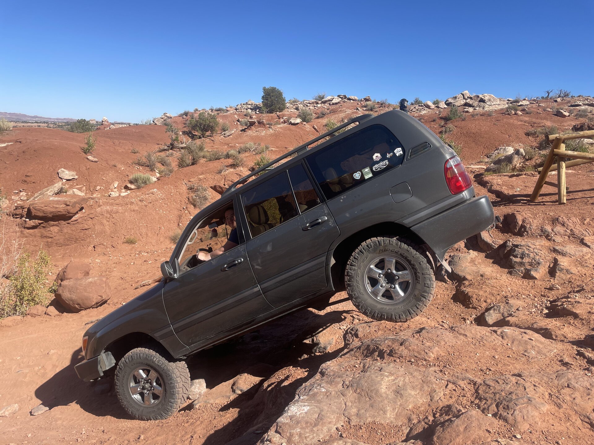

I was in love with how it looks and how it rides! My next stop was a weekend in Moab to test the new suspension! With a quick install of a fire extinguisher first! I trust my wiring skills but I like to be safe!
The cruiser performed flawlessly on the trails we ran!! I was falling in love with it all over again!!

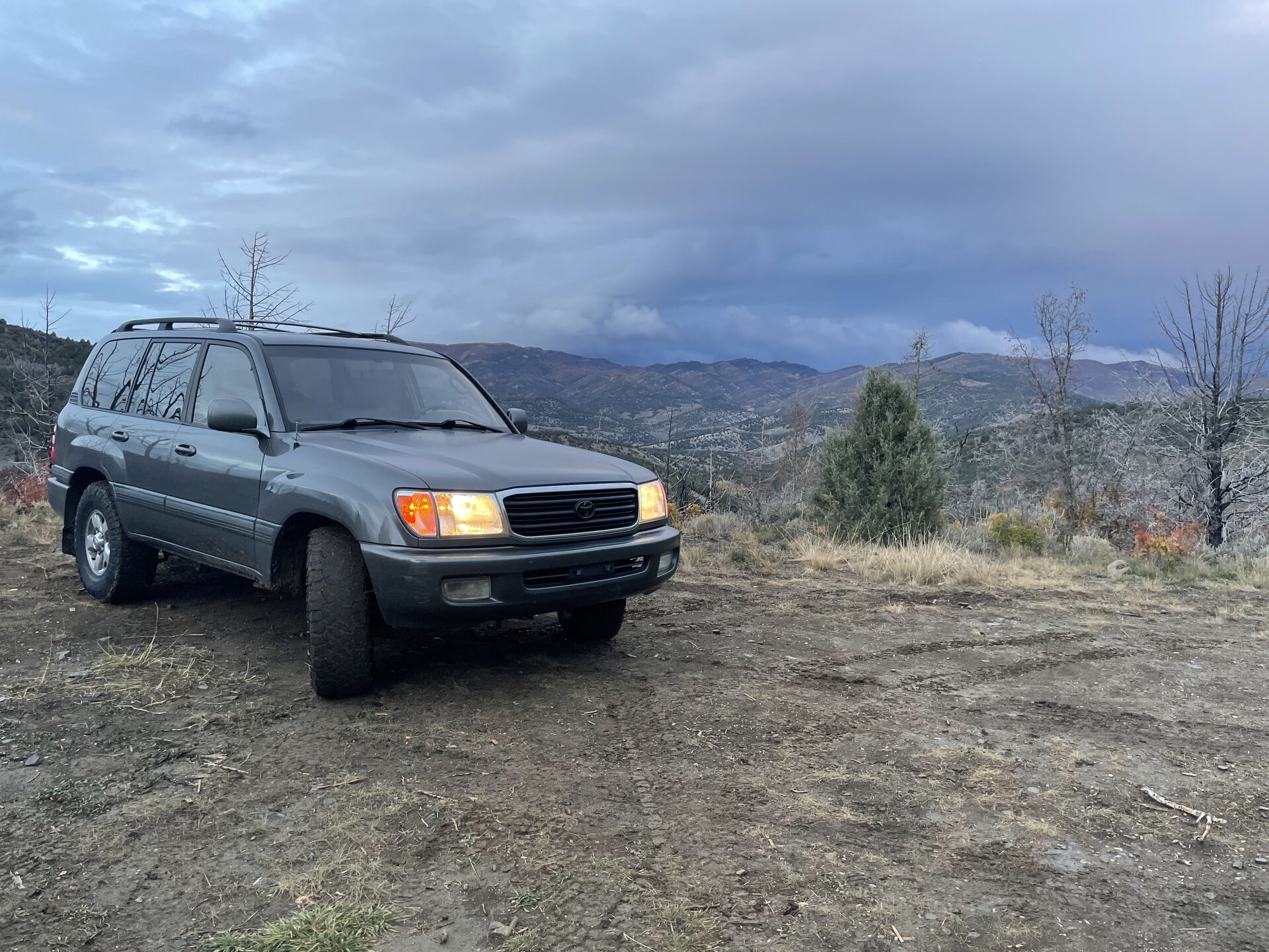

And this brings us to now! This is how my 100 currently sits.

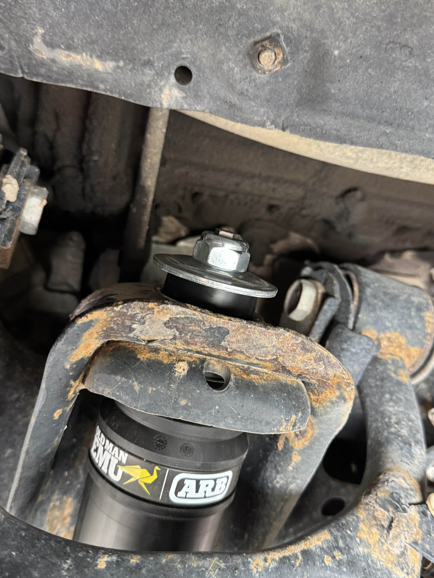

I’ve been chasing a clunk over bumps ever since I installed my OME lift. I’ve replaced ball joints, sway bar bushings, steering rack bushings, and was gearing up to rebuild the steering column. But today I was putting my hands on the suspension parts to double check things before my long drive to Washington and found my drivers side shock absorber to have a bit of play. I was able to turn it a couple degrees but it made the same clunk I’ve been hearing for months now. Thanks to Bryce and Chance at @cruiseroutfit for helping me out with getting a new shock absorber and working on warranty for the old one. My clunk is completely gone now!
There were some weird issues with the install of the new shock, ARB redesigned it and I’m not sure if I like the new design.
There is barely enough room to get a wrench on the top of the shaft to keep it from spinning
And the instructions they provide are impossible to read haha!!
