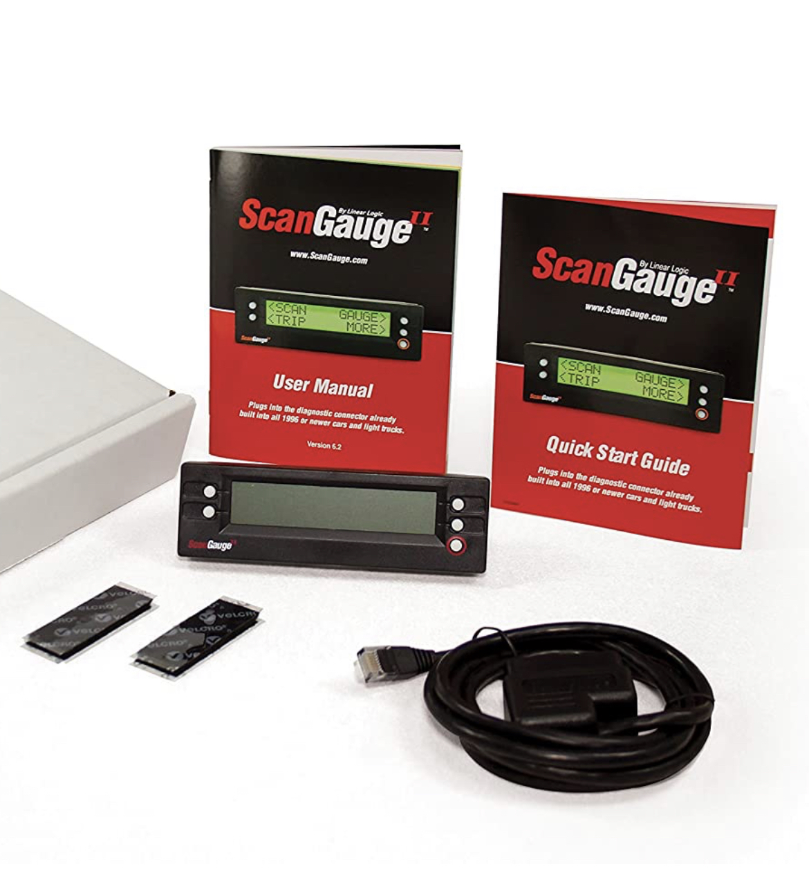

I only found out about LCs a few weeks ago. And, I picked up a 96 LX450. I was told that I should keep track of my trans temperature. What are you using to measure your trans temperature? And, what else are you keeping an eye on?
I purchased the scan gauge and wasn’t sure if this was the best option. Seems antiquated and not user friendly. I may return it. And, search for something else.
I’m researching this topic.
Scangauge won’t do trans temps

Ultra gauge is another popular option.

I happen to prefer the UltraGauge. None of them will monitor trans temps because there is no factory sensor for trans temp to the ECU. The ones that do added a sensor.

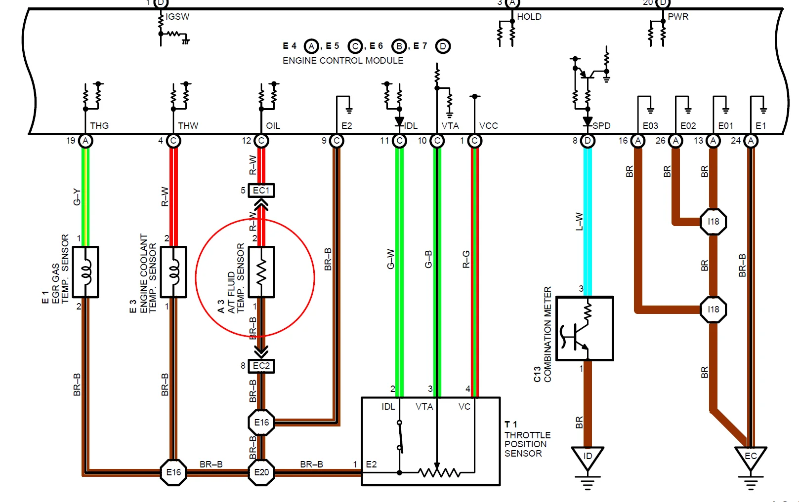

FWIW, there is a transmission temperature sensor on the LX450 (the A343F to be exact, so the '95-'97 Land Cruiser has it too). The sensor just doesn't connect directly to the ECU, but rather to the TCU, which is why the aftermarket gauges don't see it. The sensor goes to the TCU and then to the ECU, which is how it gets to the dash lights.
I have seen exactly one (one of mine, unfortunately) A343F-equipped Land Cruiser with temperature problems. To be clear though, mine are engine temperature rises I believe are related to higher than normal transmission oil temperatures. They don't get hot enough to turn the light on, but I know the clutches have started slipping, so I assume it runs hotter than it should. Since the radiator cools the transmission oil, it has less engine cooling capacity when the transmission oil is hot.
All it would take to get the signal is to fab up a pigtail to connect between the sensor output and the EC1 connector. It's on my list to do, but I haven't gotten around to it.
...from Page 131 of 1995, Drivetrain, Electronically Controlled Transmission (ECT) and AT indicator (ppg 130-137)

Thank you for the more detailed clarification.
I simply stated: "None of them will monitor trans temps because there is no factory sensor for trans temp to the ECU."
Which is correct, as you stated, but I know my UG will not monitor a separate TCU unless the ECU wants to allow that information through.
For all intents and purposes, there is no transmission oil temperature sensor, because it doesn't send a signal where it can be got. You weren't wrong.
