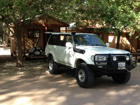

Made it safe and sound.
Sent from my iPhone using IH8MUD
And yes, it was a long drive.
I'm glad I went at night. I don't know what the traffic would have been like with all the road work going on.
