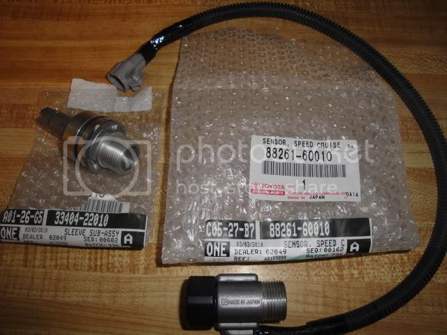

This is frustrating as heck as it just started to show up sporadically. I'm suspecting a fouled speed sensor?
Thanks for the thread CJF. I failed step 4 in this procedure. The light doesn't blink above 25 mph... What does that indicate? Bad Speed Sensor? Also where is the speed sensor?
Yup; bad (likely gear oil fouled) sensor. It's attached to the speedo near the rear of the transfer case on the driver's side.
In which case, order these parts:
Ha! What a coincidence, I was gonna post a reply with a pic but you beat me to it! This thing was caked in oil/dirt but I cleaned it up so I could see if there was a part number on it.
Anyways, here ya go...
:cheers:

Well I think I have found a problem... I was putting in the old sensor and i noticed that the cable (I imagine it rotates with the gear) that goes into the sleeve was loose... Loose as in i could pull it out. I don't know that much about this engine/trans. but I do believe there is a break in the cable or the other end.

I took the cable all the way out... Looked like it may be designed to do that... It may be normal but I'm not quite sure. I'm just a rookie.
That's the speedometer cable ya doof. :lol:

My cruise control failed diagnostics with the speed sensor too. I removed the sensor and reconnected the speedometer cable. All the cruise control speed sensor does is pass through with via shaft to the speedometer cable. I guess they did it this way due to some models not having cruise control. I do not care about cruise control but wanted to know what was wrong. The speed sensor is cracked. I probably won't replace it unless I can find one cheap. I don't use cruise control off road. :)
