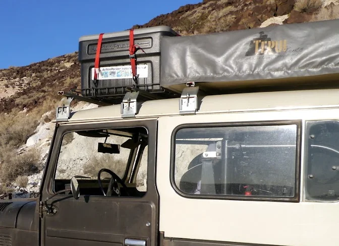

I've used unistrut cross bars with a similar design. You can bolt the cross bars directly to the roofnest rails. You may need to use a shorter bolt so it doesn't protrude as much. Then with the bars attached, you would lift the whole thing on top of your car and bolt it in. That's really the only way you're gonna be able to fasten the tent on. Even with the other bars you linked, you probably won't have enough room to get to the bolts and mounting plates with the RTT on the car, there's just not enough room to slide your arm in.
Second picture shows the bars already attached to the tent and lowered together. For my application I removed the RTT mounting rails completely and just bolted the tent directly to the bars, so there was only about 1" of clearance between the roof and bottom of the tent.

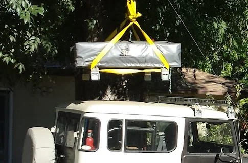

I bought a small overhead electric winch that I hung from the upstairs balcony that overhangs the driveway and tried this. It's a trick to have it perfectly balanced when lifting. Hence that winch is just sitting in my garage. Now that I think of it, I should probably get rid of it.
After doing it once, I found it was too much of a headache to do it on a regular basis. Now that I think of it, I should probably sell that winch now since I don't foresee any use for it and it's been sitting there for years now.

That's an older pic of one of the many methods I've tried when installing the RTT. The single line winch method works, but not that well, as you've found out.
Now I use a ceiling storage rack lift which has a cable on each corner, so balancing isn't a problem anymore. That combined with front runner quick release mounts is the easiest way for one person to attach and remove a RTT. If I had gotten the motorized lift it would be a 5 minute procedure, but even manually I can have the tent on and off in less than 10 minutes by myself.
