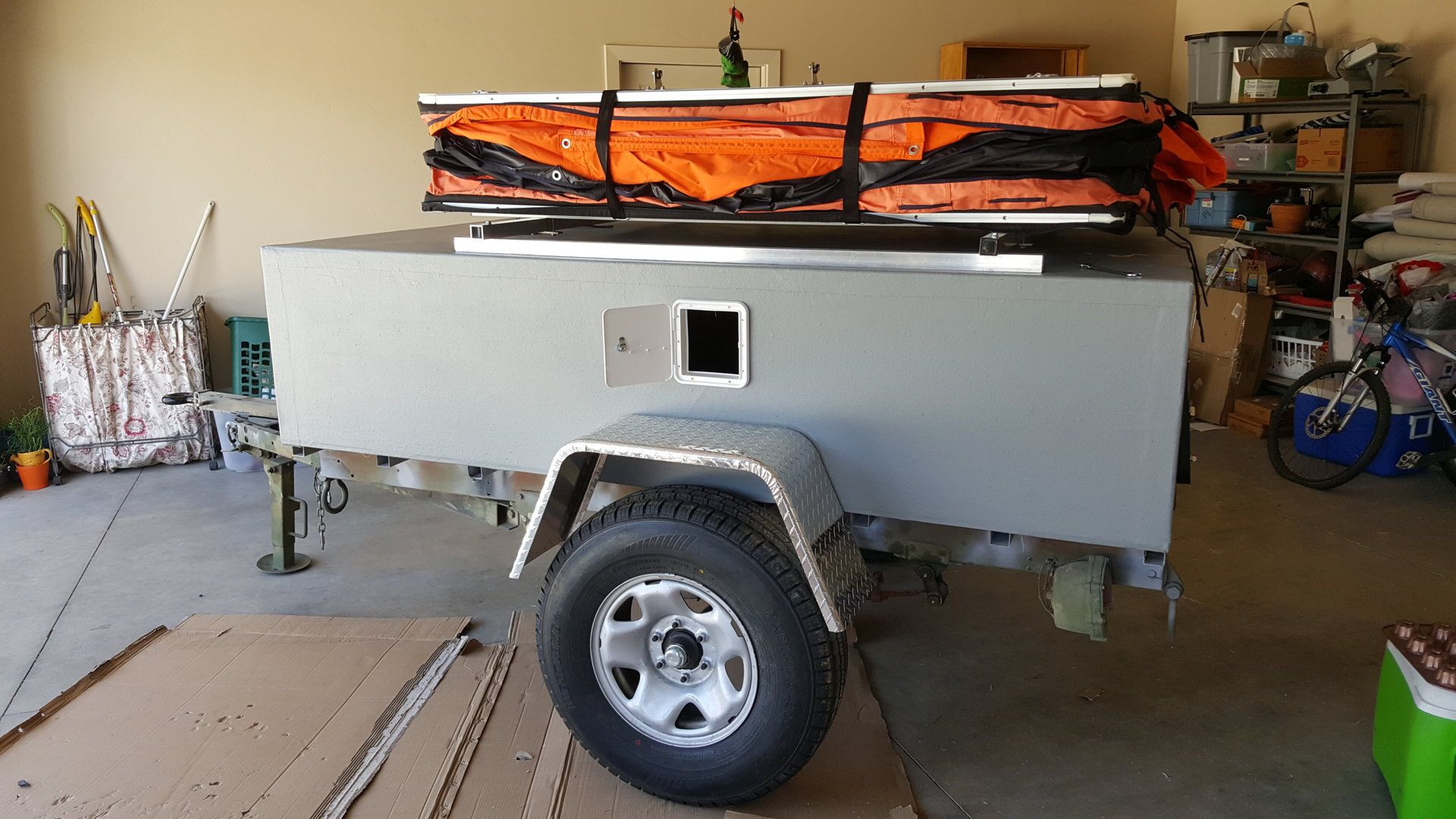

I'm building an off road trailer and will add a rooftop tent. I have not settled on a tent yet. Could I still build the cross bars now? If so, how many and what spacing? For design reasons I can't make them adjustable. Also how wide (thick) can each individual bar be, and how much clearance should there be above the hard top of the trailer?
Thank you
Turned out simple: 1 1/2" heavy wall aluminum tube. Still putting in the end caps. Super deal at local metal supply, about a buck a foot.
