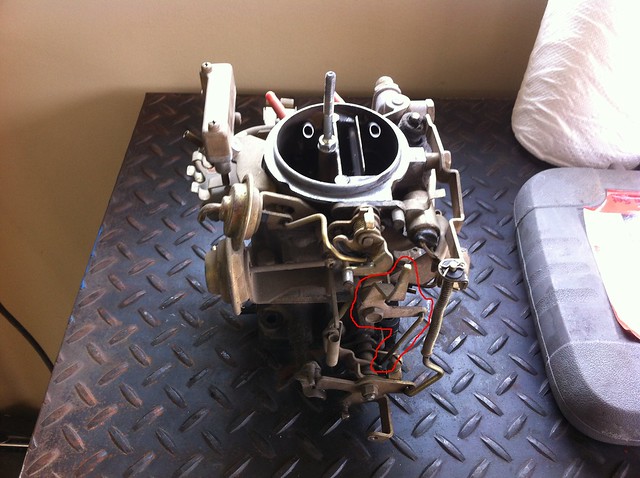

So here is another question, comparing the two carb's in post #19 above, the second being a Jim C desmogged carb, if I were to remove the choke opener does that mean that the linkage circled below could also be removed? From reviewing my photos it appears that once the choke opener is removed this linkage no longer has any function:
