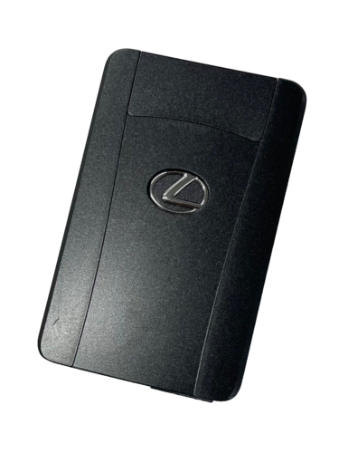

Credit Card Key for Land Cruiser (/LX570)
Wow, they did the key in the card?
Yes. The guy at ace was nice. He did the blank for the card and the blank for another big fob that I had all for a whopping $18.
I got my credit car key to work using TechStream! I have a different version of TechStream than Eric Sargeant used, but..... I screwed something up!!! The lock/unlock functions of my original key fobs do not work and the ability to lock unlock the vehicle by touching the handle also does not work. Please help!! I can't lock my car now. But, I can start my car with the credit card key =)
Update! Fixed it. Had to register the ECU. Whew, I was worried that I would have to go to the dealership to fix it.

Can someone please confirm the smart card and blank key part number for a 2013 LX570? Anyone bought a used key from the below seller and did it work fine?
TRANSMITTER SUB-ASSEMBLY
Part Number: 8990450482
KEY, BLANK(CARD KEY)
Part Number: 6951530350
Were they able to get the physical card key to work?
I am confused as to the question. The card portion works great. The key works as well, was cut by the Carlsbad Toyota.
Yup, I read that again and it didnt make any sense to me either. I meant the manual key, not the electronic key. I had mine cut by a locksmith and it didn't work. Does yours have the triangle cut-out portion cut into the tip? My original has it, but the copy doesn't
both of my keys have the triangle cut out in the tip.
I scrolled back up and verified that the part number that you linked to was the same one that I ordered. When you received the key blank, was it already cut?
Negative, needed to be cut. Carlsbad Toyota charged me 5 bucks. But I think they gave me the wrong price.
