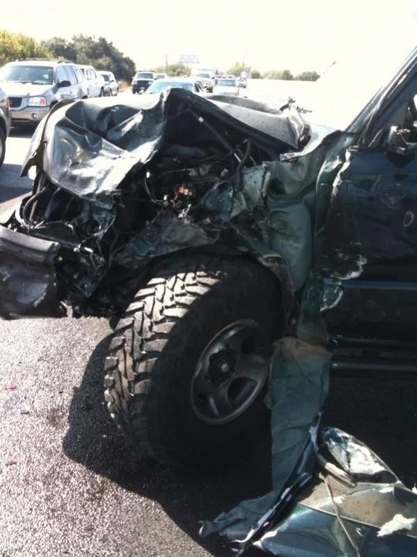

Just two weeks ago my 93 was totalled as I hit head on the rear of a PARKED van on the freeway going 55mph. My front left tire/wheel is dam near under the drives seat and the front left is dam near smashed againt the fire wall. Passenger compartment however was nearly perfect. Aside from my left ankle getting sprained and a general soreness, I crawled out the back window with a slight limp and some glass scratches on my left arm. I rode away in the cab of the flat bed she was on. No big.
I'm replacing it with another 80. Not even considering another vehicle. I walked away from an extremely violent crash. I'm sold. Pics and thread coming soon...

You guys may be right, newer is better. But my proof is in the pudding. My 93, 55mph dead hitting a parked van in the #1 lane. Walked away.
