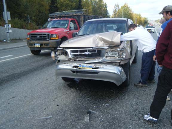

Had some guy crash in the back of me doing 45 to 50 Mph. I was stopped.
There was some damage to the tailgate due to the spare being pushed forward. No frame or other major damage. This could have been the end of the cruiser if not for the bumpers.
So anyone building bumpers keep the spare away from the gate about 4-5 inches and brace the swing with a stop.
4x4 customs in Georgia did the build for me. Worth the investment.
Unfortunately the impact was sent to the back of my neck. I had my bell rung for sure.
It looks like the back of your frame has been tweaked up a few inches. Still, that's amazing considering the impact, and the size of the vehicle that hit you!
That ain't no little lightweight sedan!

That's awesome how that FROD is smashed and you came out almost unscathed! Sucks that had to happen to you but at least you were prepared.
