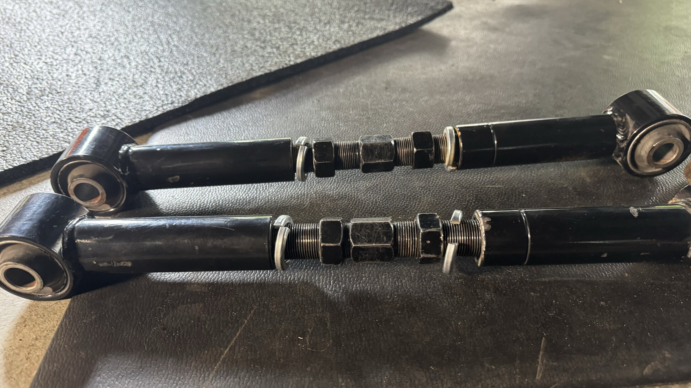

Purchased some $100 upper control arms as a temp fix for my vibration problems.
I was waiting for funds for the Dobinsons after the metal tech ones fell through..
Anyway, I had a tough time getting the dobinsons ones in (I had to lengthen them more for a better pinion angle)
so I realized I could use the cheap turnbuckle style to push the axle enough to fit the new non turnbuckle dobinsons control arms.
For those that are wondering, the non turnbuckle adjustable arms cannot be adjusted while installed, while the turnbuckle style can. Just thought I’d post this for anyone that was having trouble installing adjustable links, $100 for a tool is pretty inexpensive, especially if you have multiple 80’s, although I think this would work on 4Runners with linked rear ends as well.
I was waiting for funds for the Dobinsons after the metal tech ones fell through..View attachment 3678863

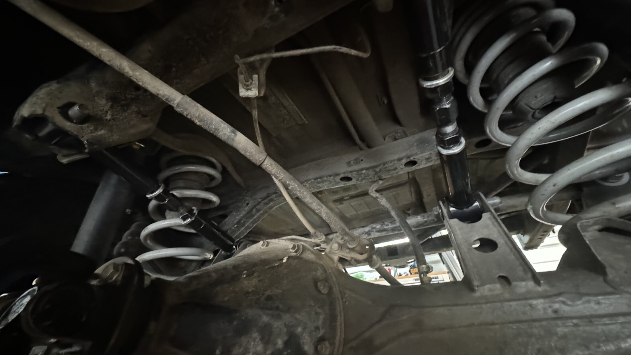

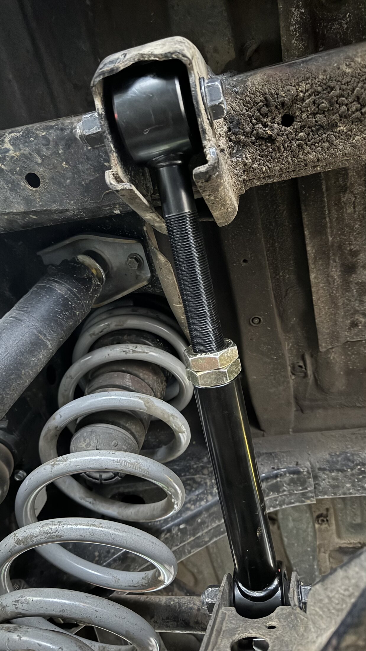

Anyway, I had a tough time getting the dobinsons ones in (I had to lengthen them more for a better pinion angle) View attachment 3678869so I realized I could use the cheap turnbuckle style to push the axle enough to fit the new non turnbuckle dobinsons control arms. View attachment 3678871

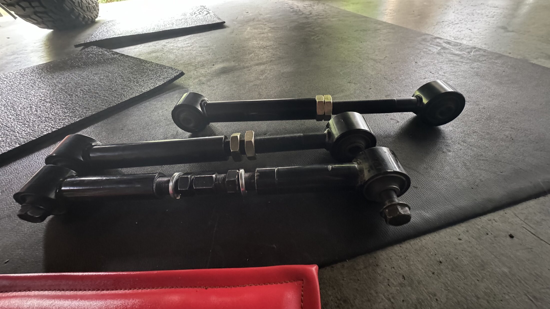

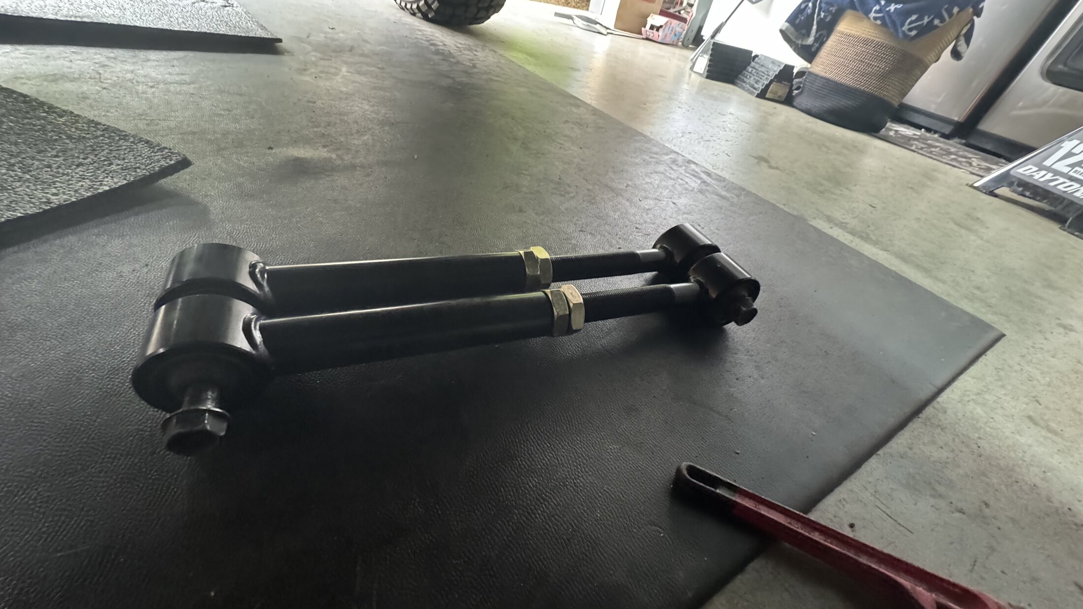

For those that are wondering, the non turnbuckle adjustable arms cannot be adjusted while installed, while the turnbuckle style can. Just thought I’d post this for anyone that was having trouble installing adjustable links, $100 for a tool is pretty inexpensive, especially if you have multiple 80’s, although I think this would work on 4Runners with linked rear ends as well.View attachment 3678872View attachment 3678873
A ratchet strap works well for positioning the axle 😎
