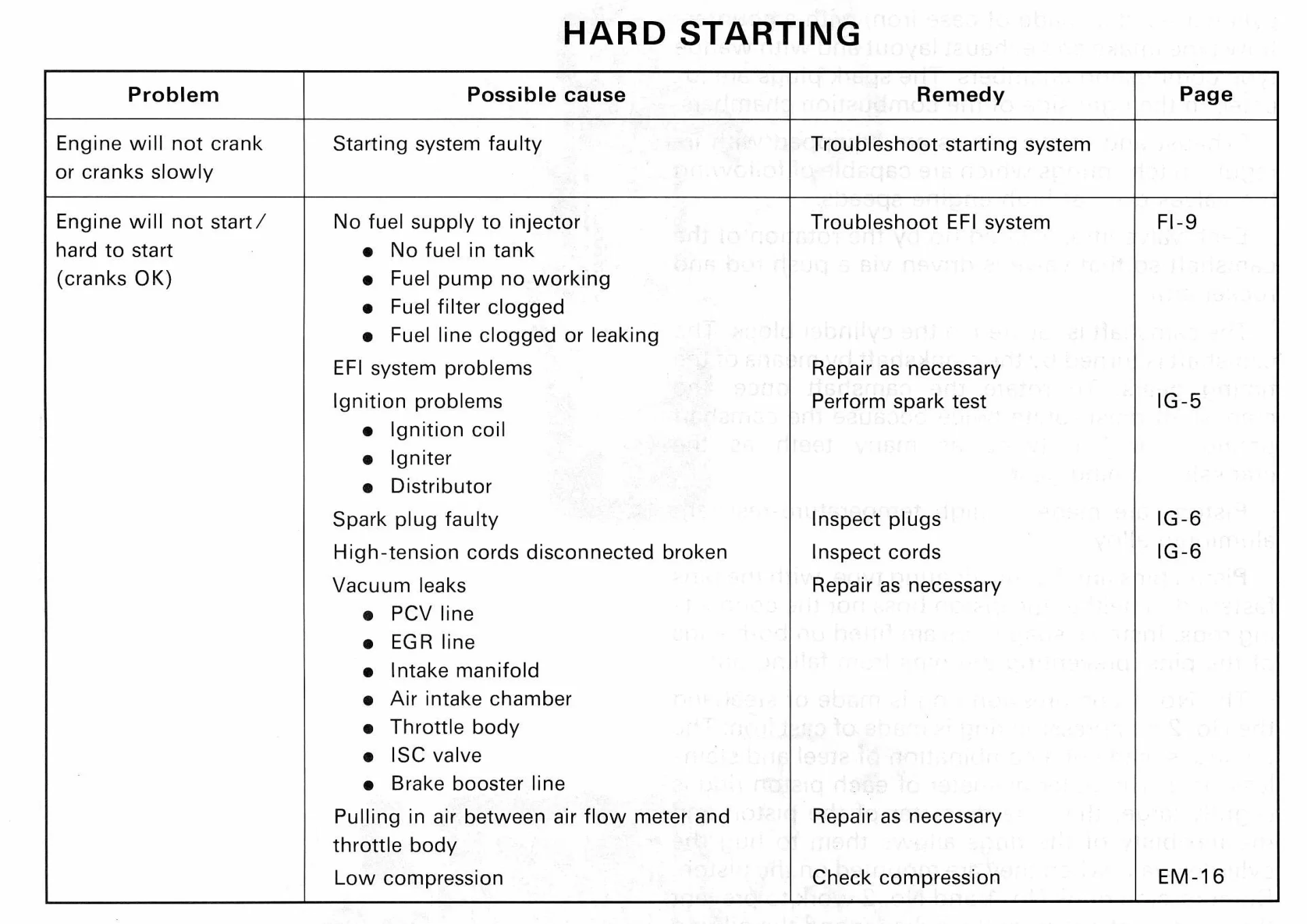

I have noticed that my truck cranks for a bit before firing. It cranks strong, ultimately fires, and then runs well. I looked through the FSM but did not find anything related to delayed firing. Any ideas would be appreciated. This is a 1988 FJ62 with electronic fuel injection and a 3FE engine.
Does this FSM page help?
Does it do it when cold or sits for a while or it does it every time? Check fuel pressure and volume also cold start injector.
