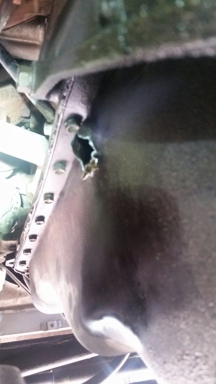

I had just finished climbing a relatively short (<2 miles) hill and was driving on flat highway struggling to 60mph and the tranny kept shifting between 3rd and 4th gear, when it all happened. Puff of black smoke, hole in the side of the oil pan and that's all she wrote, for my 3FE with 186,600 miles on it.

OUCH! Thats odd for it to lose it with no warning and at that low mileage, bummer. I would like to know what happened inside the motor, or perhaps what conditions led to the failure but that's a lot of what ifs.

Something was going on. Some severe neglect happened prior to you owning it. You driving it was the straw that broke the camels back.
