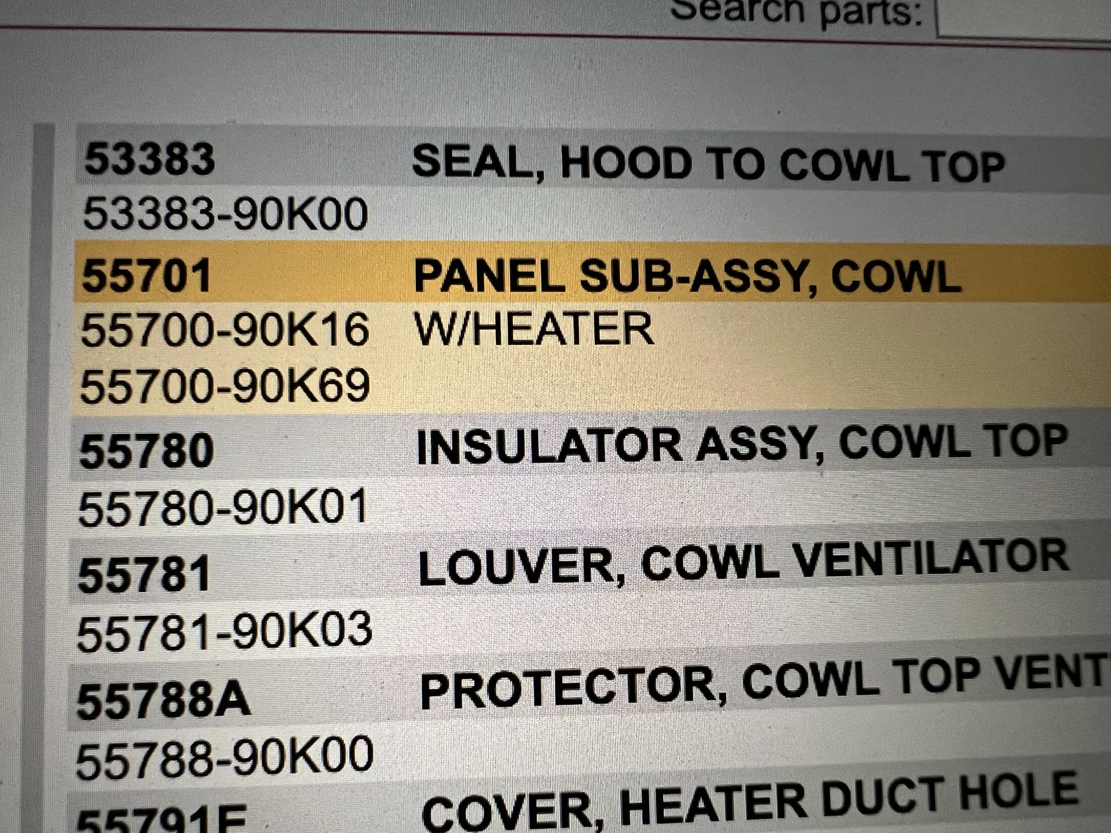

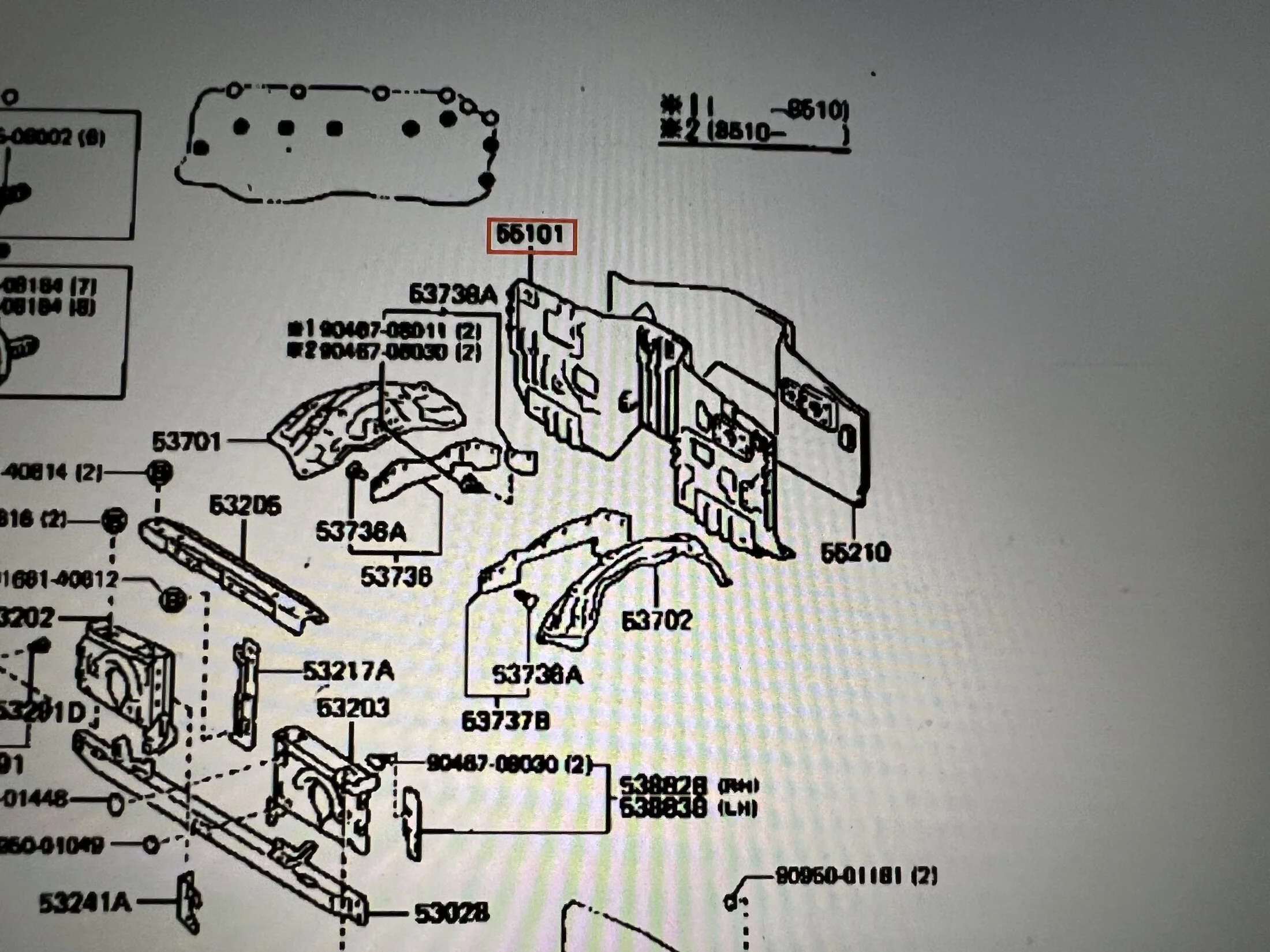

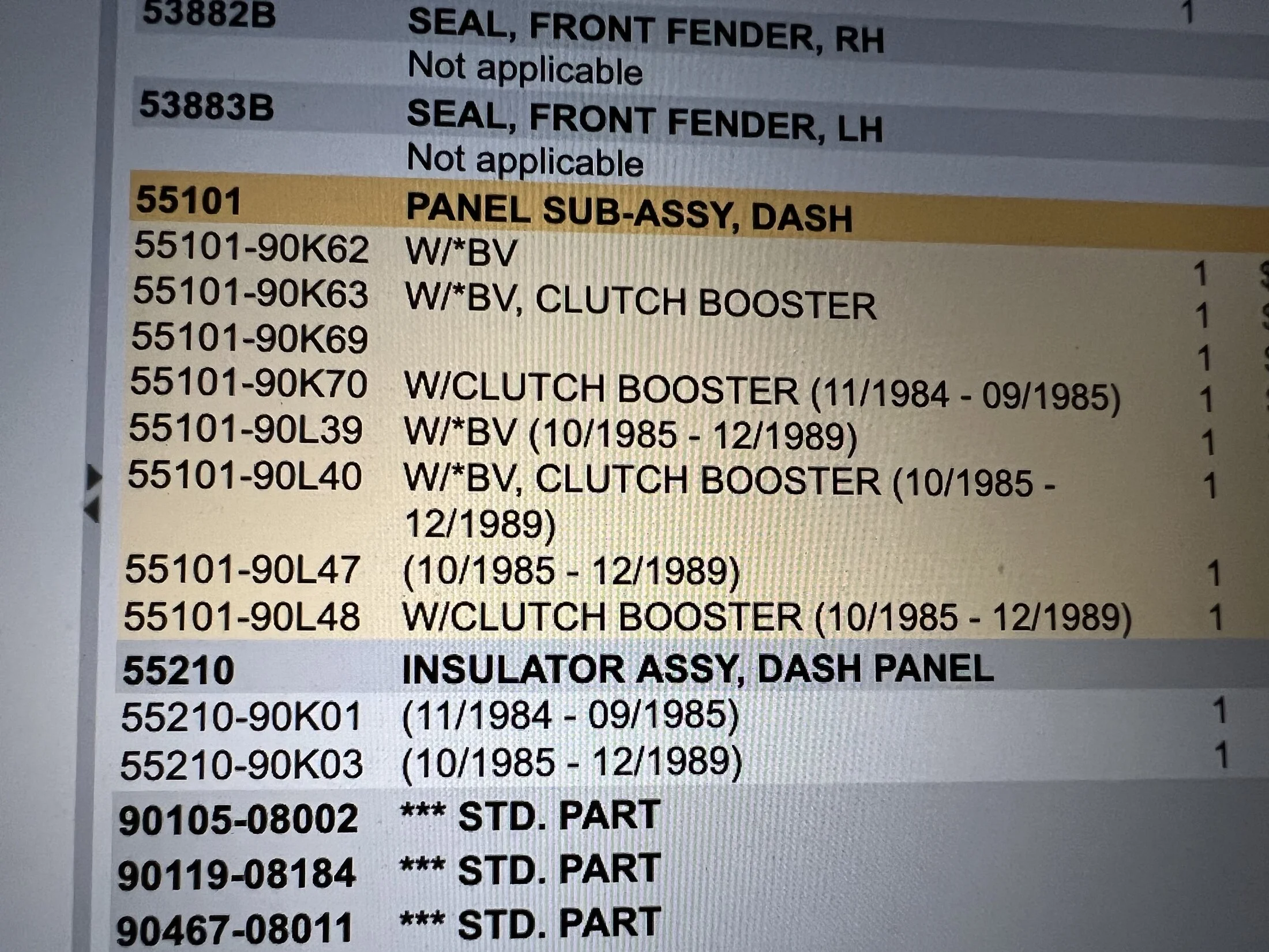

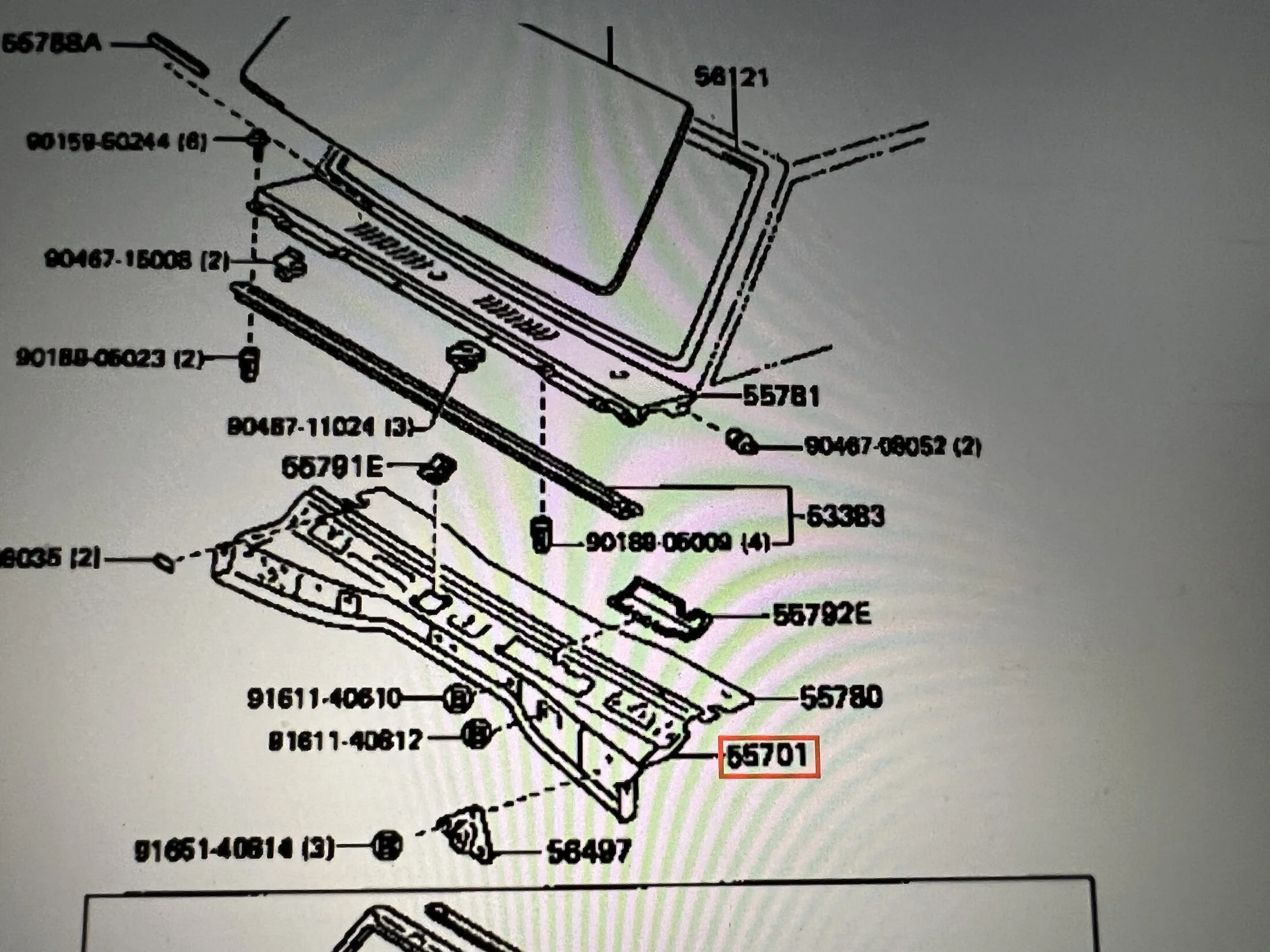

I am in the midst of rust repair on my BJ74 and will need to replace the cowl panel under the windscreen. Does anyone know if a panel off a newer model 70 series would fit or has the body with changed over time? There are a couple of people wrecking early 90's 70 series that I could scavenge a panel off or if the body width is the same I'm tempted to buy a new replacement from a 79 series.
I will post some pictures later on this afternoon to show the progress and where I am up to. Vital life lesson learnt with this car, never buy from a boat builder. They are wicked good with bog!
I'm guessing as long as you get one from another narrow nose it should fit. Some small stuff might be different, but I would think the big box would be the same.
Parts pictures don’t seem to show correctly. Don’t know what you actually want.
