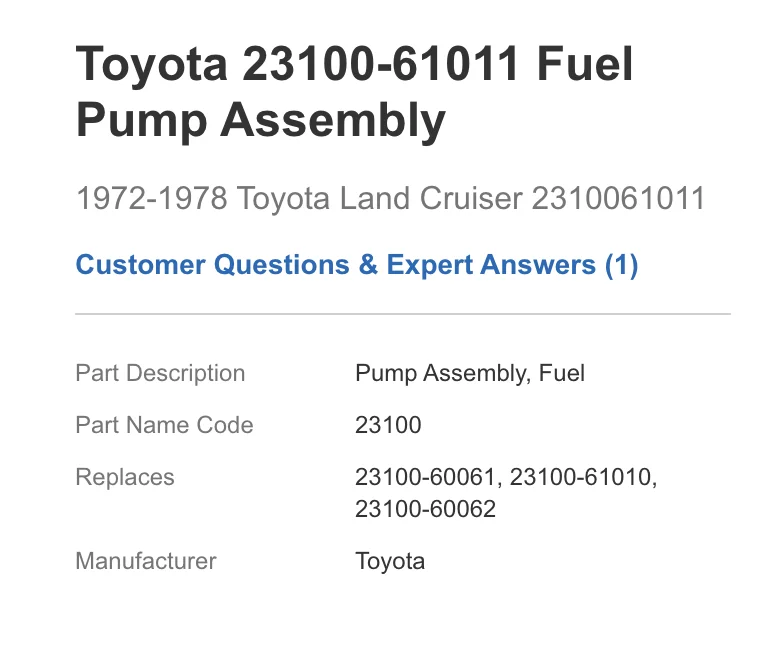

Correct Fuel Pump for 03/1970 F155?
Does it really replace the 23100-69035?
Other than the offset in the inlet, it is the same pump. If you HAVE to have a straight in, straight out, you can drill and tap the extra boss. Or you can buy the NOS one I have in the classifieds.šŸ˜‰
