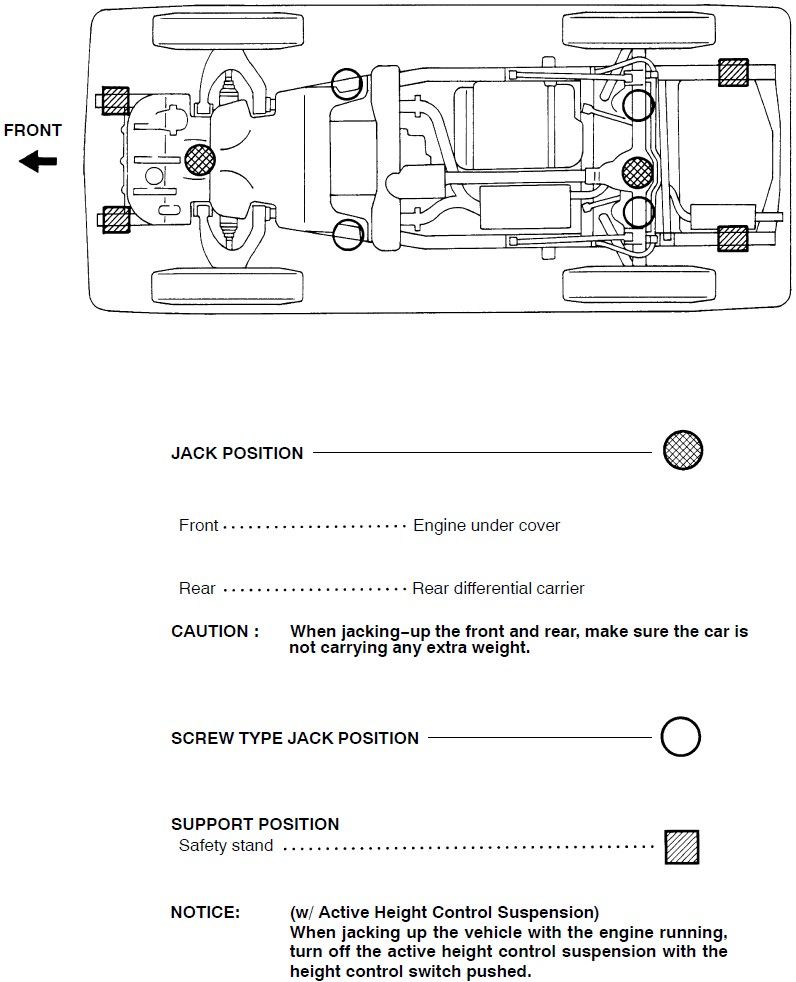

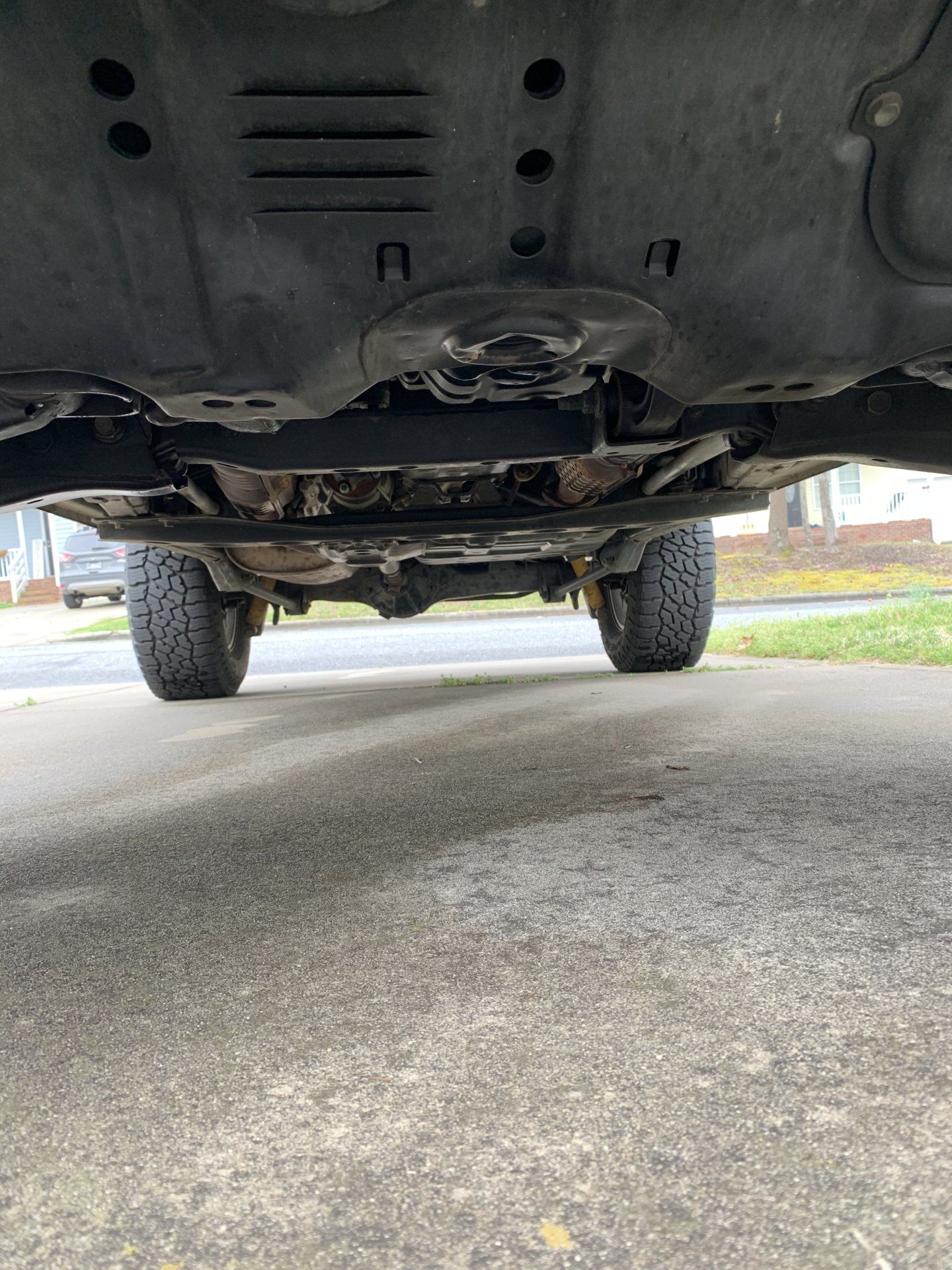

Yes this is the spot. It’s that circle. But still get the LCP jack support, it’s awesome for frame/axle lifting.

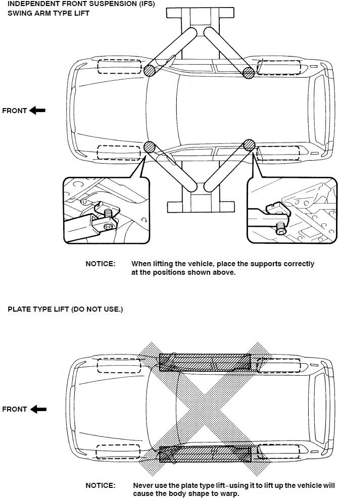

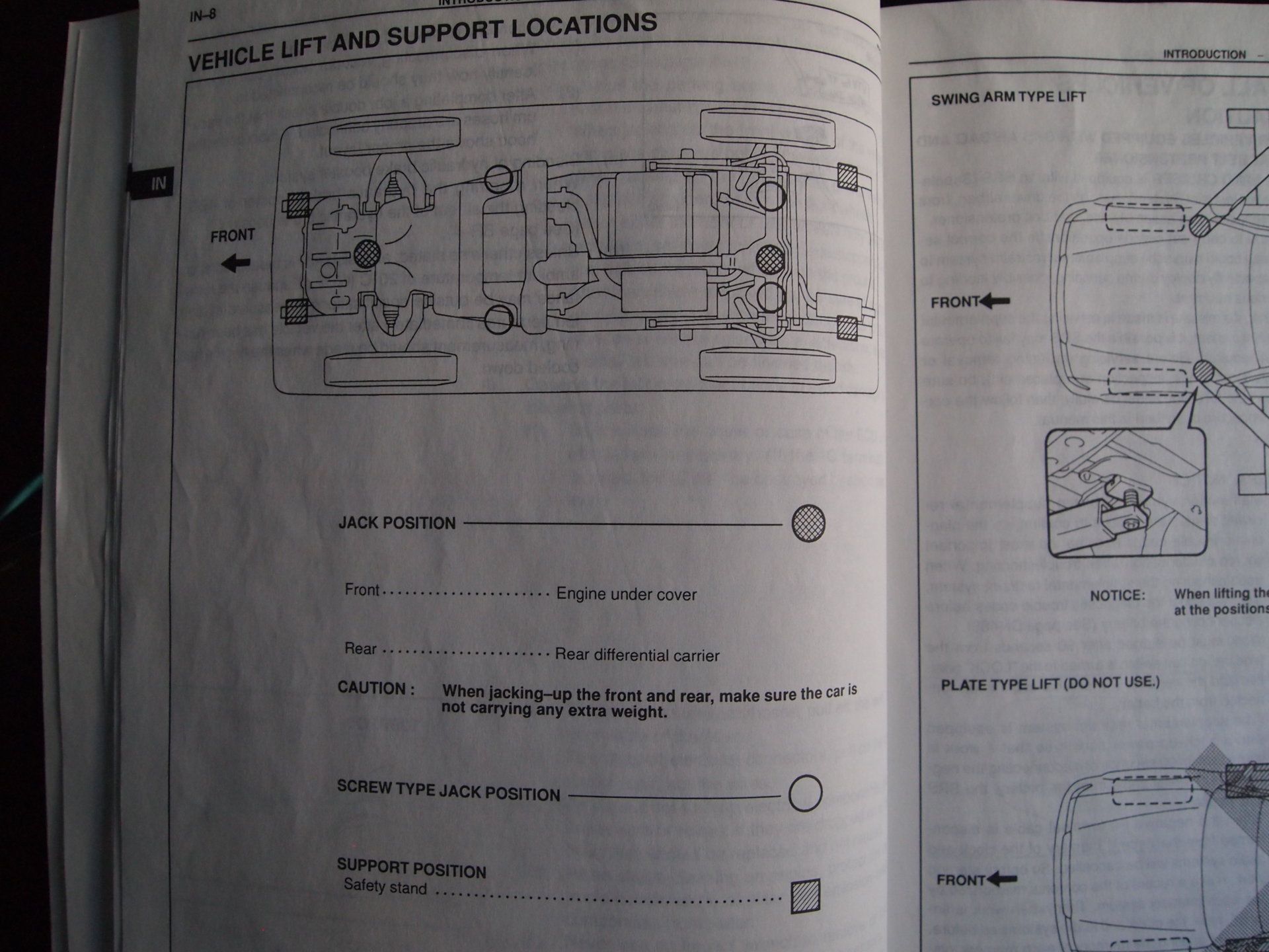

Just when I closed this one for myself, I was watching a video on steering bushings replacement and voila:
Hi, where is the lifting position to raise the rear end of the 200 in order to expand the coil springs and install a spring helper/ spring booster? I‘m using the car jack. Thanks.
JACK POSITION
  • Front: Engine under cover
  • Rear: Rear differential carrier
[/QUOTE]
I'm guessing the same positions as on the 100 Series. I think you'll need more than just the bottle jack to get the coil out.
