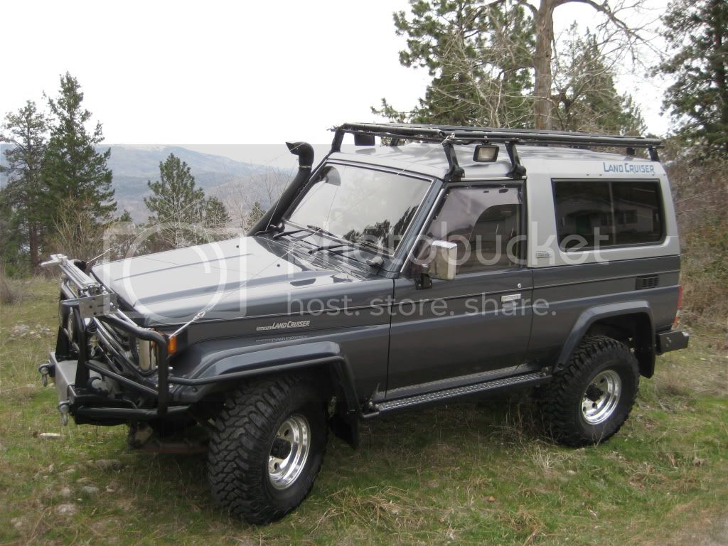

Hi All,
Just changed over my winter tires for summer rubber and bought the Cooper STT's 33x12.50XR15
Thought I'd start a long term review where I evaluate these so l'll be commenting on these over the course of their life.
Tires are mounted on 15x8 Eagle's and they were mounted at 168624km.
I run 35 psi on highway
Tread depth is 11/16th's and it will be interesting to see how much they compress when the weather and the tires heat up.
I chose the Cooper STT after a really successful run with the Cooper ST in the same tire size. I put over 80,00KM on those and they have about 1/4 inch tread block left.
I then went to the Mickey Thompson Baja ATZ and with about 20,00 km on them, I lost 2/3 of the tread depth, and I couldn't keep them balanced. Lots of chunks out of the tread block from running on logging roads. They weren't bad on rock and rather dismal in the mud.
First impressions of the STT is that they about as quiet as the Mickey's and ride comfort is great with no wobble of loud humming. Conversation is easy I hear more noise from the roof rack.
The tread design extends far down the 3-ply sidewalls for greater sidewall protection and puncture resistance. It looks like I'll have a little less difficulty climbing out to ruts. They are also close to a D rating (C I) and it think this is becaus it has a 3 ply carcass construction
Not as many plys as with the Toyo MT as its not an E rated tire but for price and for the fact that the E's would be a very stiff on road ride, I went with my positive experience with Coopers after running their winters as well.
Something I really found interesting is that they are more comfortable than my 235x85xR16 winters
And they look friggin awesome on the truck

Here's a few pics:
be interesting to see how you go with them, i have cooper ST's on my cruiser, and i would never buy coopers again, mine are chipped to all hell, they are quiet on road though,
Coopers dont have a great name in oz. Not they are such a bad tyre,its that the advertising builds them into something they are not .
Coopers are famous for reneging on warranty because you took them off road LOL
That chipping seems to be fairly common especially when used in desert conditions
Yo John,
Those look great......lets go get-em dirty.
Hi Marlin,
Getting these out and in use is the whole point. Let's figure out Apex.
You will like them. I know I do.

Regarding your roof rack -
do you have any idea what mpg penalty it is costing you?
what size tubing is it made out of ? assuming its a custom made rack.
Not sure on the Fuel mileage and I've never really worried about that based on the Accessories I want. However, I did go with lighter schedule 40 aluminum pipe and aluminum flatbar for the platform (pipe's about 1.5 inches I think) and the bars are thule. Strong enough for me to walk over.
I did the same for my 60 series but used aluminum flatbar riveted directly to the Thule bars
Running the 1hz I get about 580km on 75 liters commuting

The roof rack is a custom build using Thule bars as the base and fastened to the roof gutters. I attached the Thule bars going to the rear with aluminum gussets that I riveted to the Thule bars going across the cab. The platform is bolted with stainless carriage bolts onto the Thule bars
The aluminium platform was scavenged of a rack I had made for the truck but was badly engineered by the fabricator. He was after pretty and not functional. I thought different and cut it apart to suit the set up you were looking at.
On my 60 series, I used 4 Thule bars and pop riveted aluminum flat bar to it to create a platform. Simple and effective. The flat bar was 1/4 inch thick by 3 inches.

Damn that is a nice looking RIG.
That tread pattern looks like it would fluff or scollap very quickly especiallky iof you air down then drive on the blacktop and would also not grip if you brake hard in the wet especiallly the rear.
They would also be crap in sand and possibly hence snow.
Gravel they would also be crap as no side grip (and hence wander left/right in corers) and they would slide over the top of the gravel and not down.
A lot of people have huge blowouts on Cooper tyres here in Australia, quite often on gravel, given how much they cost, I don't think I'll ever buy a set.
