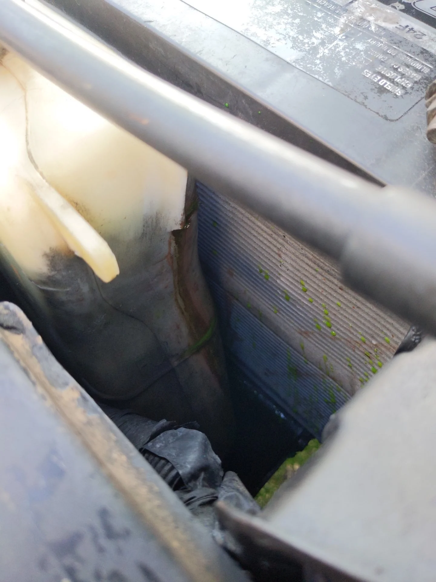

Hi all currently stuck at a gas station in Gorman, CA. I have a new to me 91 FJ80 w the 3FE. Noticed the temp gauge almost hit red and got the truck off the highway and into a gas station. There's a crack in the coolant reservoir with coolant bubbling and leaking all over the place.

The overflow tank has a factory vent tube that is too short, and coolant is dumping onto your battery tray and everything behind it. Get a longer tube and and run it down below the battery and wirings. I doubt your reservoir is cracked...
