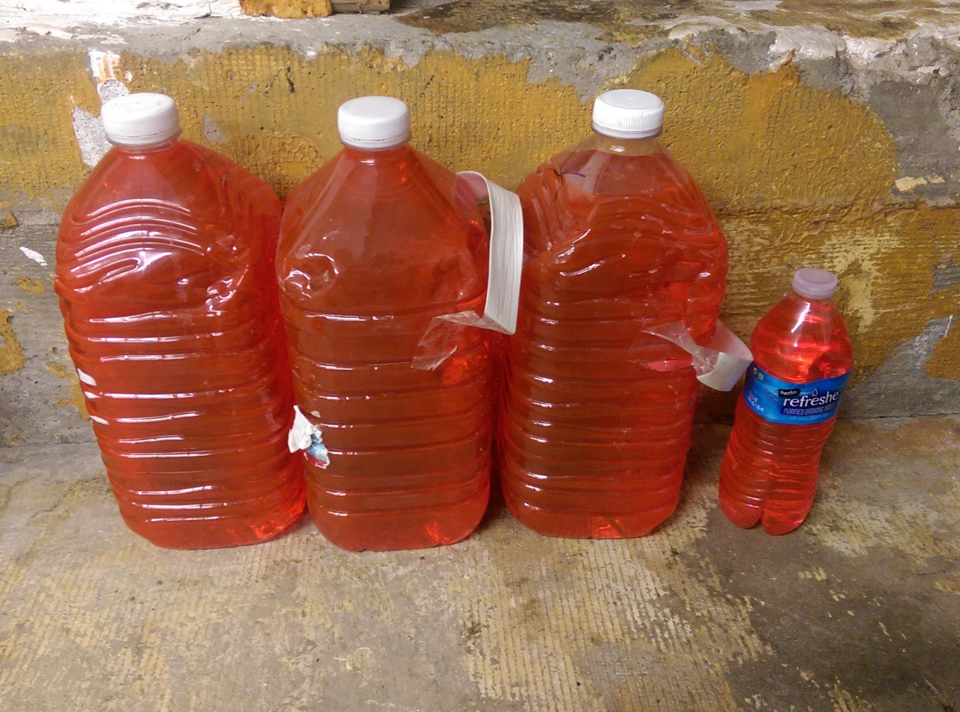

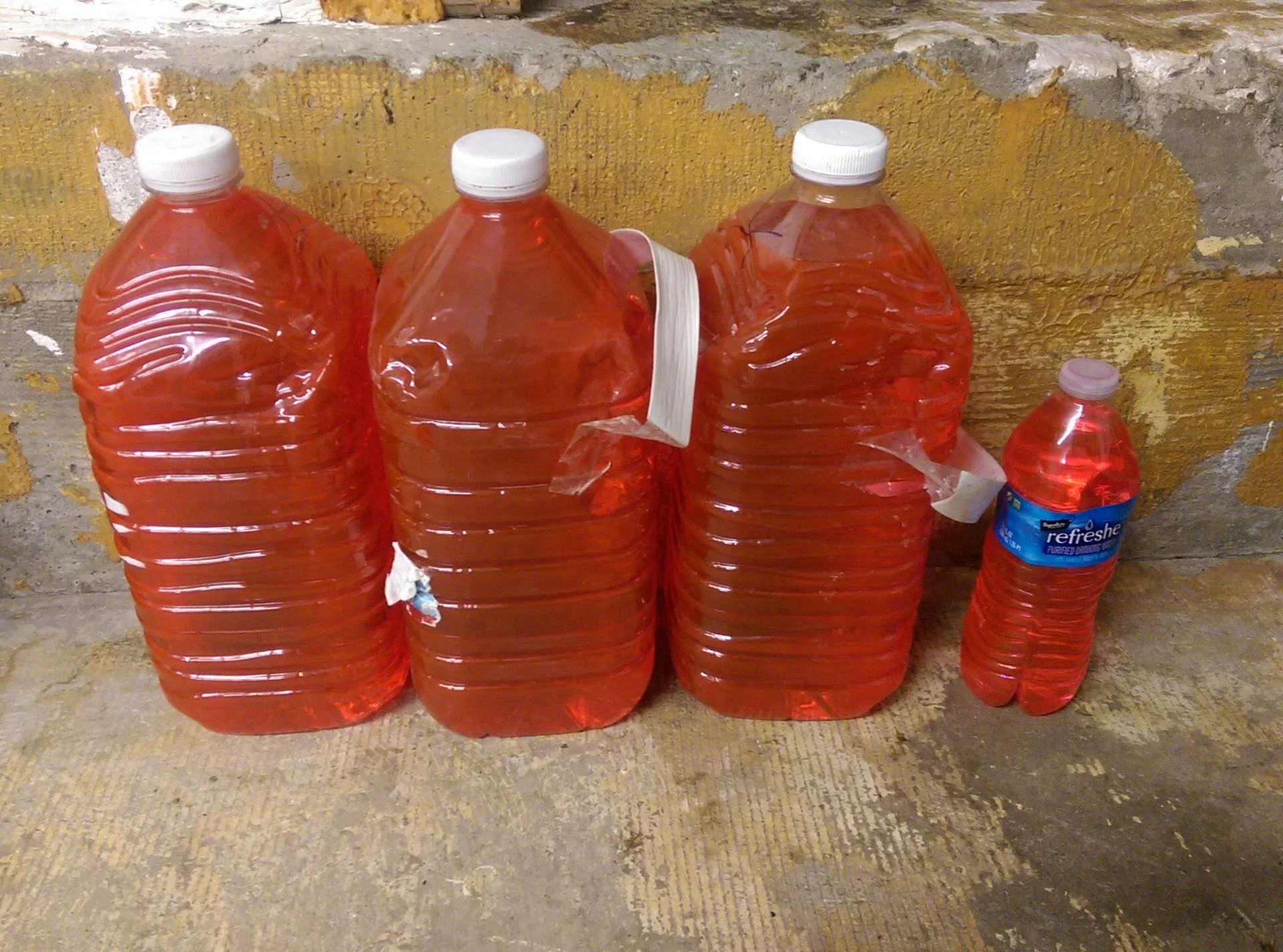

As a data point I was able to get 3 gallons from just draining the radiator petcock and both engine drain ports, plus another 2/3 quart from the reservoir. This represents roughly 70% of the system capacity.
Coolant looked pretty good, much better than what was in my Tacoma at 135k miles.
I just drained from the radiator & block on both sides & filled. Forget I much I got but I think more than 3 gallons. At 57k the coolant was super clean.

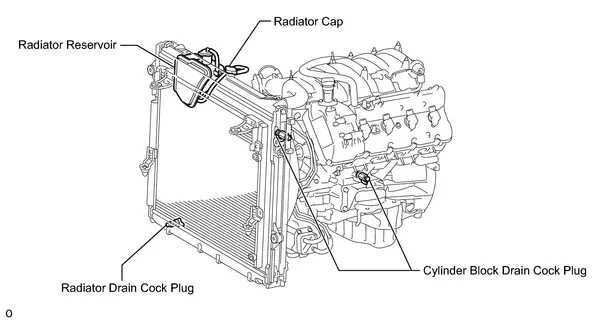

Also, I have a picture (see below) of where the cylinder drains. Any tips on how to access them? Easier from above the engine or below? How do you guys drain the fluid without just letting it pour all over the ground? Can you attach a vinyl tube to it like the brakes and AHC bleeder plugs? This is my first radiator drain so I want to do it right and try to keep as much off the ground and contained for proper disposal as possible.

No you do not need to remove the bumper and grill to drain the coolant. The FSM says to remove that to replace the radiator, which I did, but as I understand it's possible without.
To drain the coolant, you'll need to drain the radiator and 2 engine drains.
To drain the radiator simply open the petcock on the bottom, passenger side. Should be a yellow knob.
To drain the engine you'll need to open two drain valves, one on either side of the engine as shown in your picture. The PS is easy to access by jacking up the truck a bit and looking in the wheel opening. The DS is a bit harder to see but it's there. I used some 5/16" ID tubing to fit over the engine drain nipples and direct the coolant into a bottle. I could reach the PS by hand, the DS I had to tape the tubing to something rigid (I used a paint stick) to guide the tubing onto the nipple. You'll want to have some ratchet extensions, swivel heads, etc to make opening the engine drains easier.

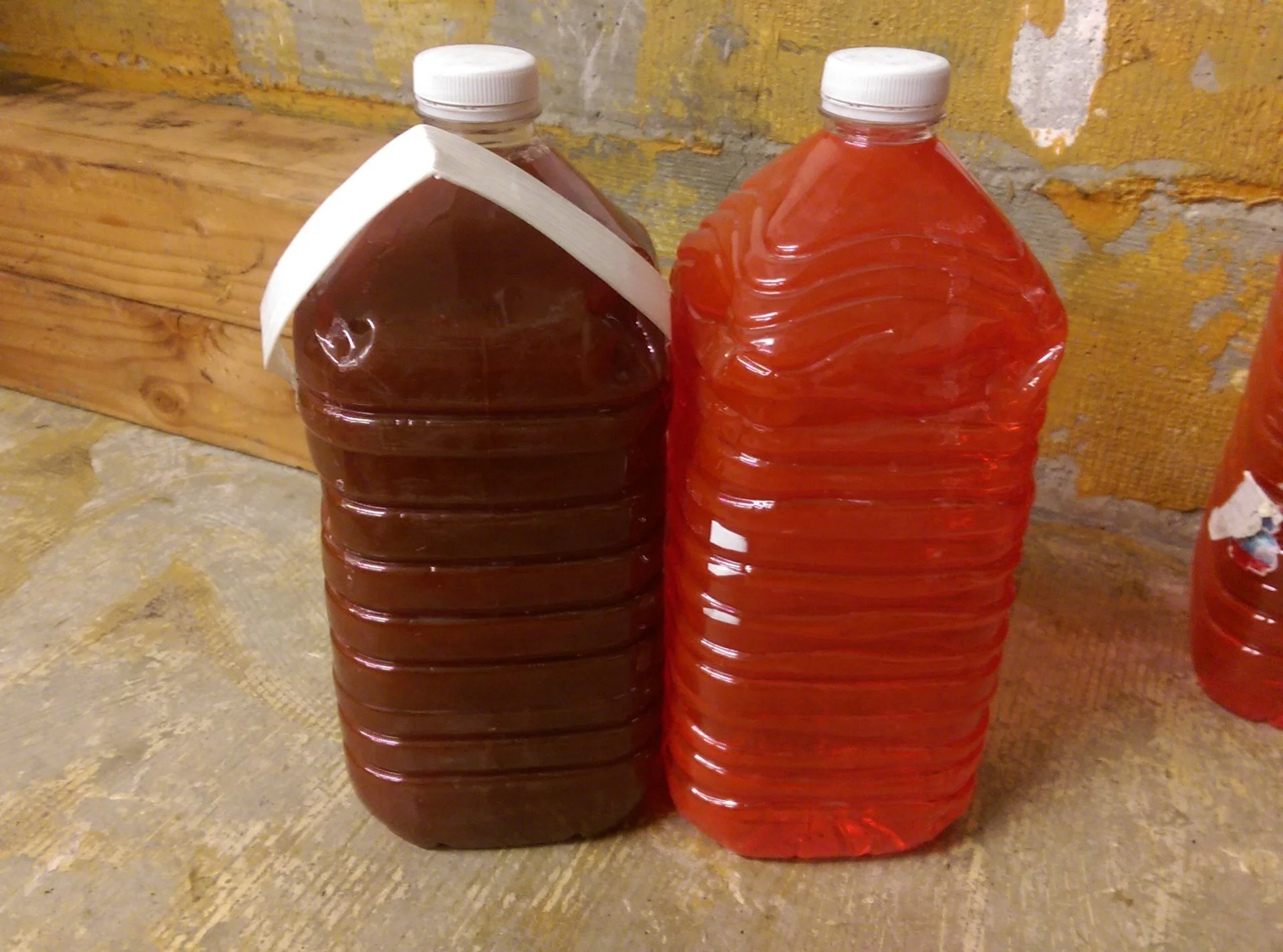

So, got this done the other day....mostly. For the life of me, I could not get the passenger side engine plug loose. It doesn't help that it's extremely awkward and you have to use a magical combination of universal joints and extensions on your socket wrench. However, I put a good bit of force into it but was worried about stripping it or worse, breaking something that would require taking half the engine apart to fix. It would be good experience but not something I'm ready to sign up for just yet.
Based on the look of the fluid coming out, I'd say it was in pretty good shape and I'm not overly worried by the fact that I couldn't get that side open. I was able to get just under 3 gallons out. Would appreciate any words of wisdom on the look of the coolant that came out. Am I correct in thinking that it's in good shape and should not be too worried about the fact that I could not get the one drain plug loose?

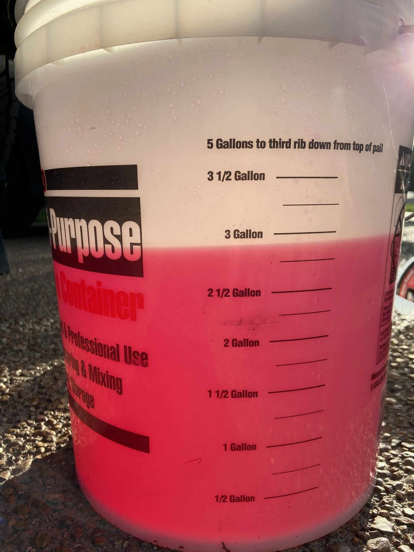

I sent a coolant sample to Blackstone at 90k and 9 years. It came back clean, but at a pH of 7.22 it was very slightly more acidic than the 7.5 they like to see. So I drained and refilled just the radiator. It took 7 quarts and I plan to do this often enough to keep annual Blackstone reports at 7.5 pH. Doing only the radiator is super easy and using a large plastic bin for draining and a refill kit eliminates any mess. My local hazmat disposal site is only 20 minutes away and takes any fluids in the LC.
I decided to do the radiator only but do it annually. It’s easy, mess free, and with the overflow right at 2 gallons.
