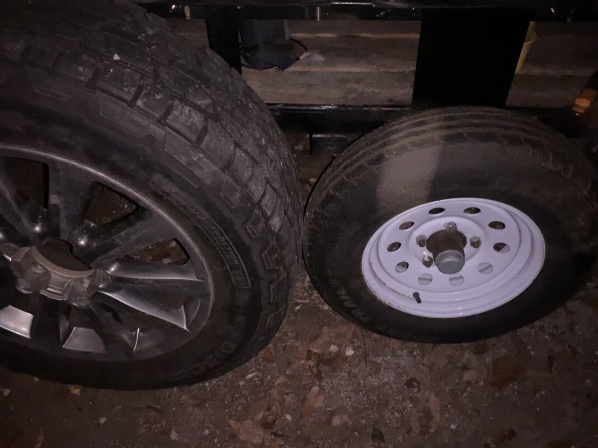

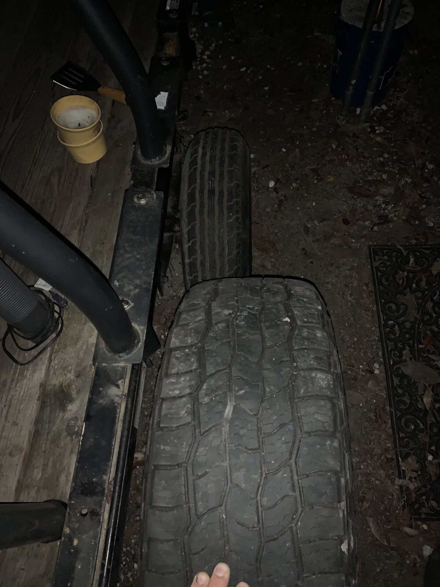

Would anyone happen to know how far is the reasonable standard that one can have a hub face from an axle perch?
If you go too far away from the spring, then too much strain, like a lever, is placed on the axle between the perch and hubface.
I’d like to upgrade my axle to a 3500 (from 2000) while at the same time moving the hub face outboards so I can mount 33” matching wheels and tires at 5x150.
Does anyone know if I could do an 85” axle with 60” perches so there is 7.5” excess axle on each side of the perches?
Reasonable standard seems to be a bit squishy (according to dexter)…a 60” spring center 85” hub face to hub face 3500 lb axle would work (my axle appears to be a 70.5” hub face to hub face and 58” spring center to spring center) …though the manufacturer would derate the 3500 lb axle to 2100 lbs.
That kind of puts the kibosh on using a basic utility trailer, adding a classic 3500 lb axle, and mounting 33” tires to it…
My spring perches (on a 5x10) trailer are actually 58”…and eyeball measuring the necessary hub face to hub face axle would need to be 96.5”…so I’m further outside what the manufacturer would even rate to 2,000 lbs.
Anyone know whether a torsion or axle-less suspension might work?
Any other ideas on how to get these 33” tires on this trailer?
