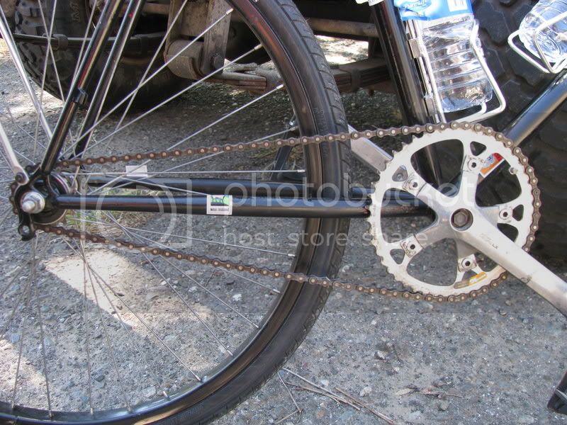

a generic frame I grinded
my first commuter (horizontal drop outs!)

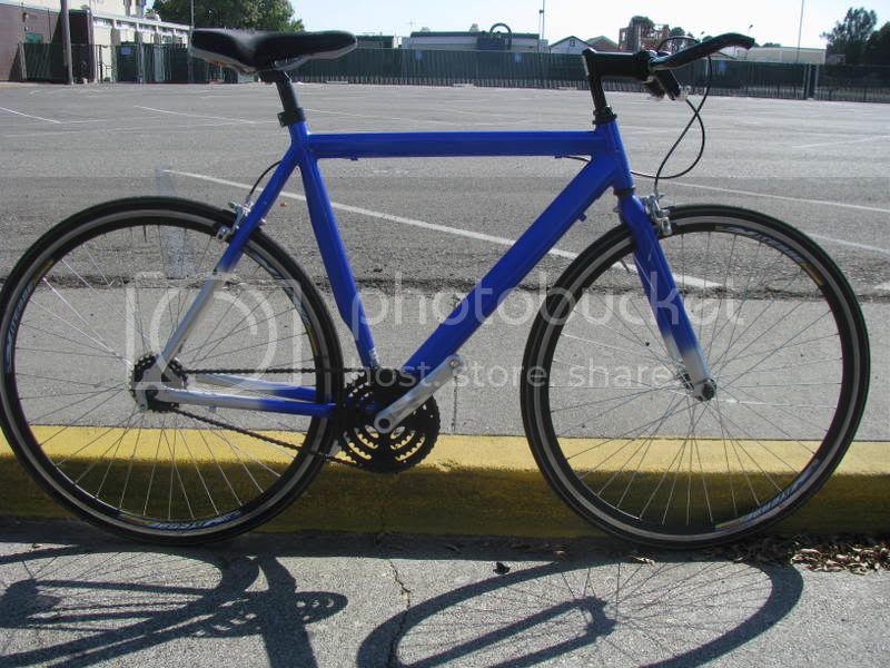

Here is my commuting ride, fed up with difficulty of stopping, I converted it to a fixie two years ago. It has been good addition to my other track bikes, and I am glad that I did that. Unlike my cruiser, it needs no attention at all.
I ride my fixed gear all the time now for fun. My commuter still has a free wheel. It is a very strange feeling when you try to slow down and the bike just keeps moving!
