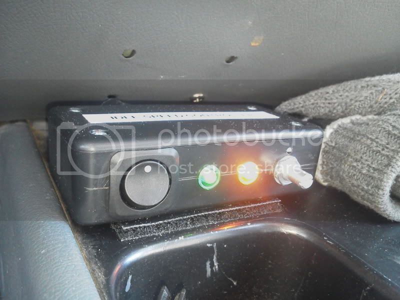

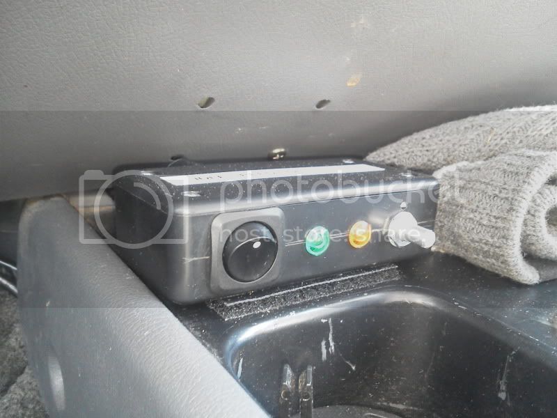

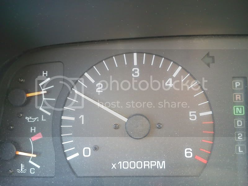

Forgot to update this thread! I finished the controller project, and packaged the electronics into a small project box from Radioshack. It works great. The main rocker switch arms the system, and the clutch engagement is tied into the potentiometer (which also has a built-in on-off switch). I added a couple LEDs for status lights. I just leave the potentiometer set at a ~1500rpm idle, and activate with the rocker switch. You can infinitely adjust the idle speed by twisting the pot, if you need to.
So far, I've used it when running the winch, and also when sitting parked while using the A/C. With the A/C going, that modded fan clutch (15k fluid) really roars at ~1200-1300rpm and keeps the inside ice cold.
Mounted it just in front of the "useless" cupholder, below the dash.
