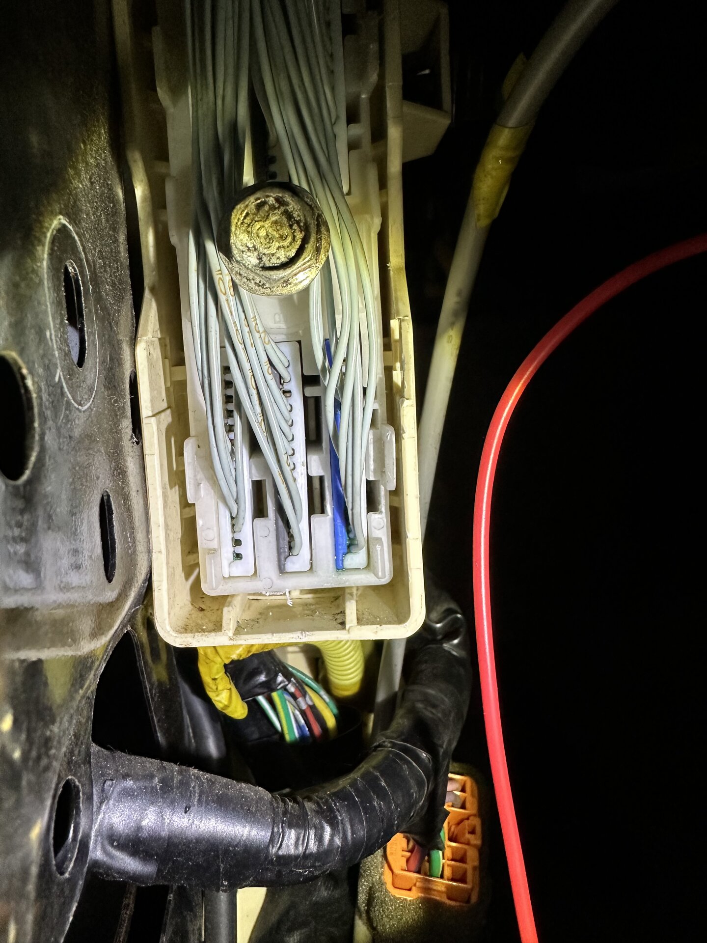

Likely this area in the driver footwell fender wall just above the dead pedal, a ton of circuits come through there. You need to pull the black end cap off (not shown here), remove the single bolt in the middle, firmly pull out the white harness assembly and you can separate and dry out all the clusters of leads.
Awesome, thanks a ton for the help. It rained some more last night so I decided to disconnect my battery, and today some drying action occurred.
The circuits must have dryed out by the time I reconnected my battery today as I no longer got warnings thankfully!
I'm going to start looking into sealing the sunroof to avoid any more water leaking down - what a pain!
Thanks again for the help. Super useful to know where the problem is at, and the area around there was definitely wet last night.

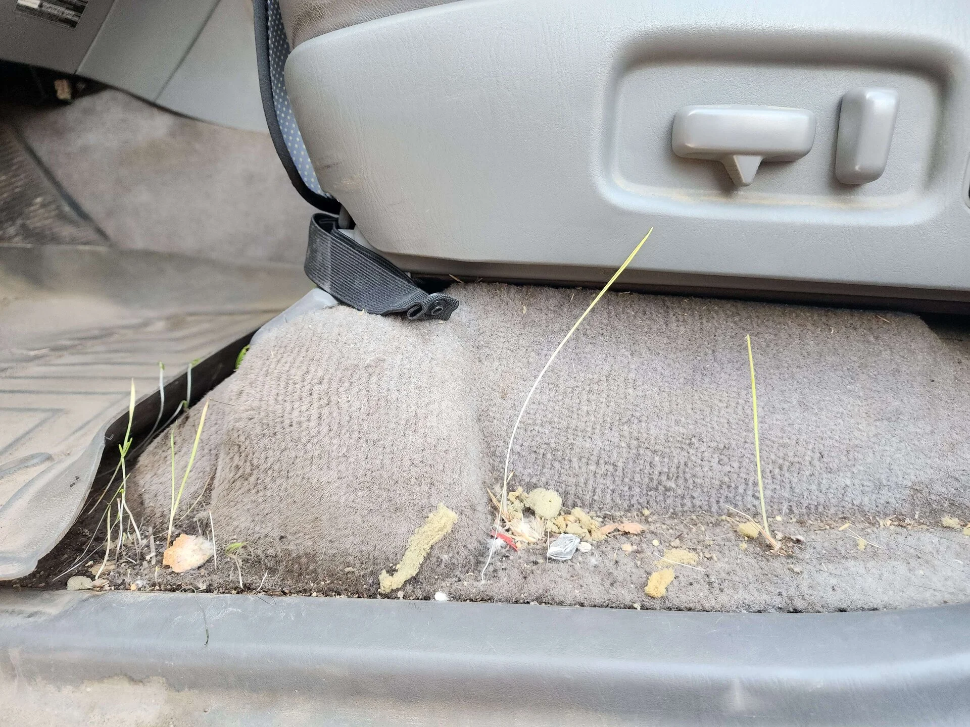

The electrical issues are just too much of a hassle justify leaving the sunroof unsealed (assuming thats the cause of the issue). The rain shorted out my car and has:
1. Caused my car alarm and horn to go off non-stop, so I had to disconnect my horns out of fear that it'll disturb the neighbors! Happened multiple times.
2. Made my gas gauge inoperable for short periods of time (showing the low gas icon when I had a full tank. Needle was on E despite full tank).
3. Caused the brake alarm to go off when the key is pulled (video above in this thread)
4. Turned on my blinkers plus lights in my car, and killed my battery.
Enjoy a picture of grass in my car :)
