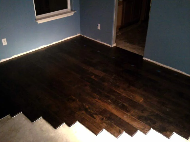

progress
Finally got to lay some wood!
Looking good. What is the name of that blue for the walls?
