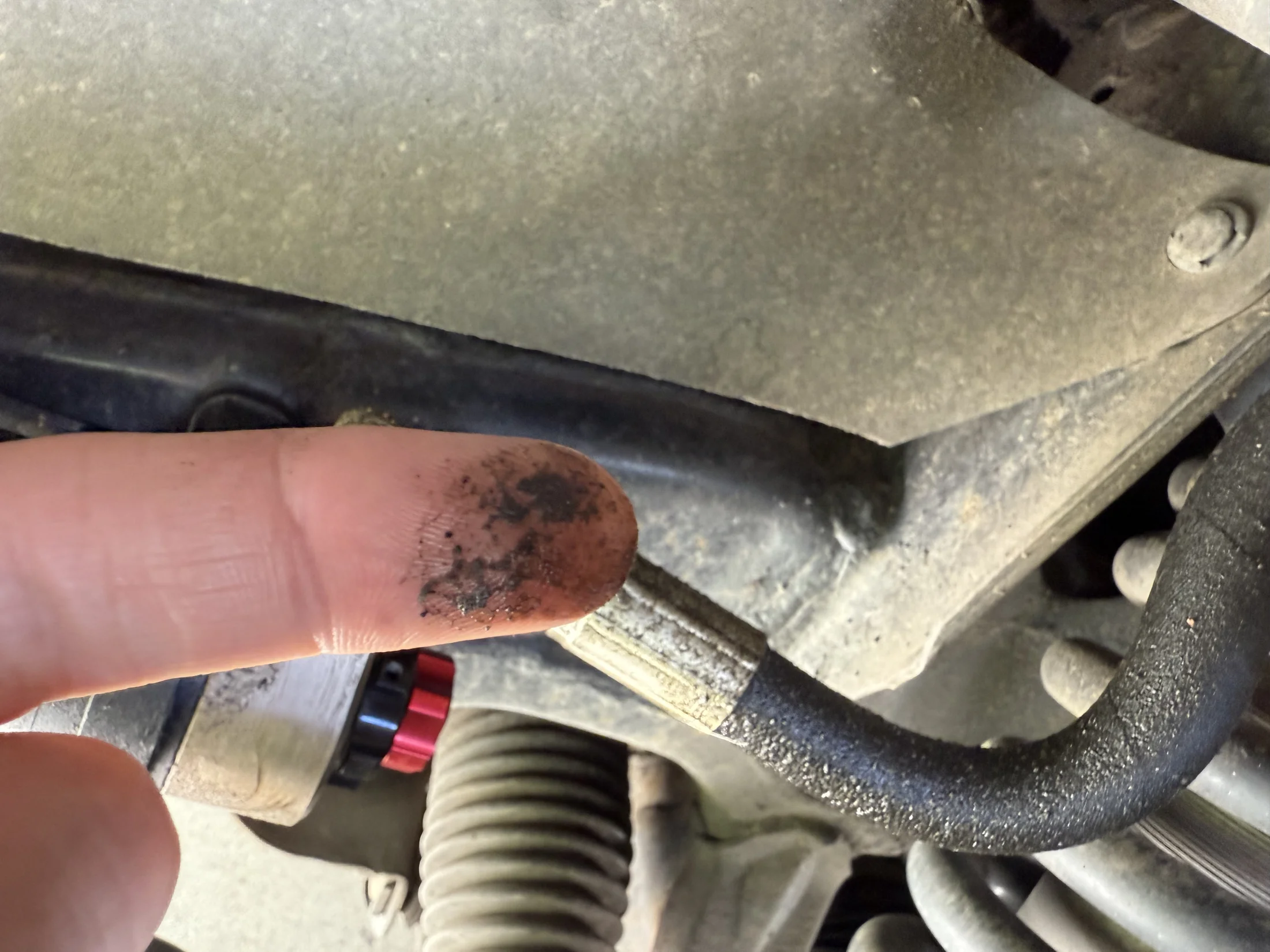

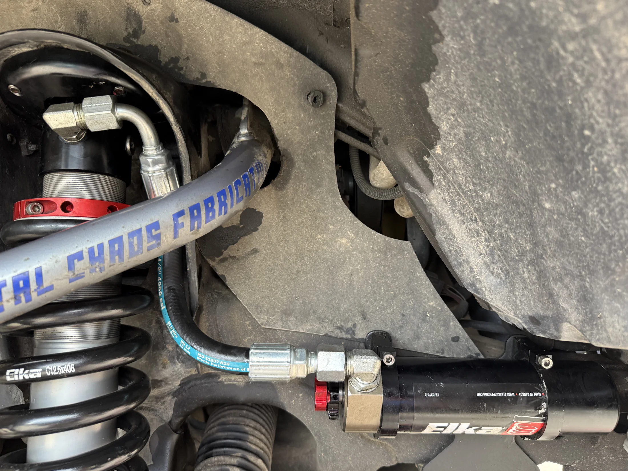

I have the DC remote reservoir front coilovers that we installed over Christmas on my 2008, they are leaking at the hose already, nothing but road miles and some cold winter temps (Elka is a Canadian company). I submitted a warranty claim a couple weeks ago and not a peep from Elka. Nothing. Nada. So I either have to pursue this through other channels or pay to have them rebuilt and the hoses replaced. Toytec can handle it and are local to me, will cost the better part of $500 and Toytec says Elka has issues with their hose manufacturer so that lines up. Elka makes Toytec’s Boss Aluma line so they probably know.

Do they use a swivel joint where it meets the resi and the shock body? Maybe if it's a rigid mount, it came loose and could be tightened up, potentially saving from a rebuild.
If it's how the hose was crimped at the fitting, then that's really not good at all.

Nothing. But I ultimately felt that I needed to get this in-house where I could deal with it due to not trusting a warranty service and it being unrealistic to RMA for an indeterminate period of time with my daily driver truck on jack stands.
$550 later I have custom 4000 PSI Gates hoses with rebuild through Toytec, who is local to me. Toytec said the hoses were dry rotted.

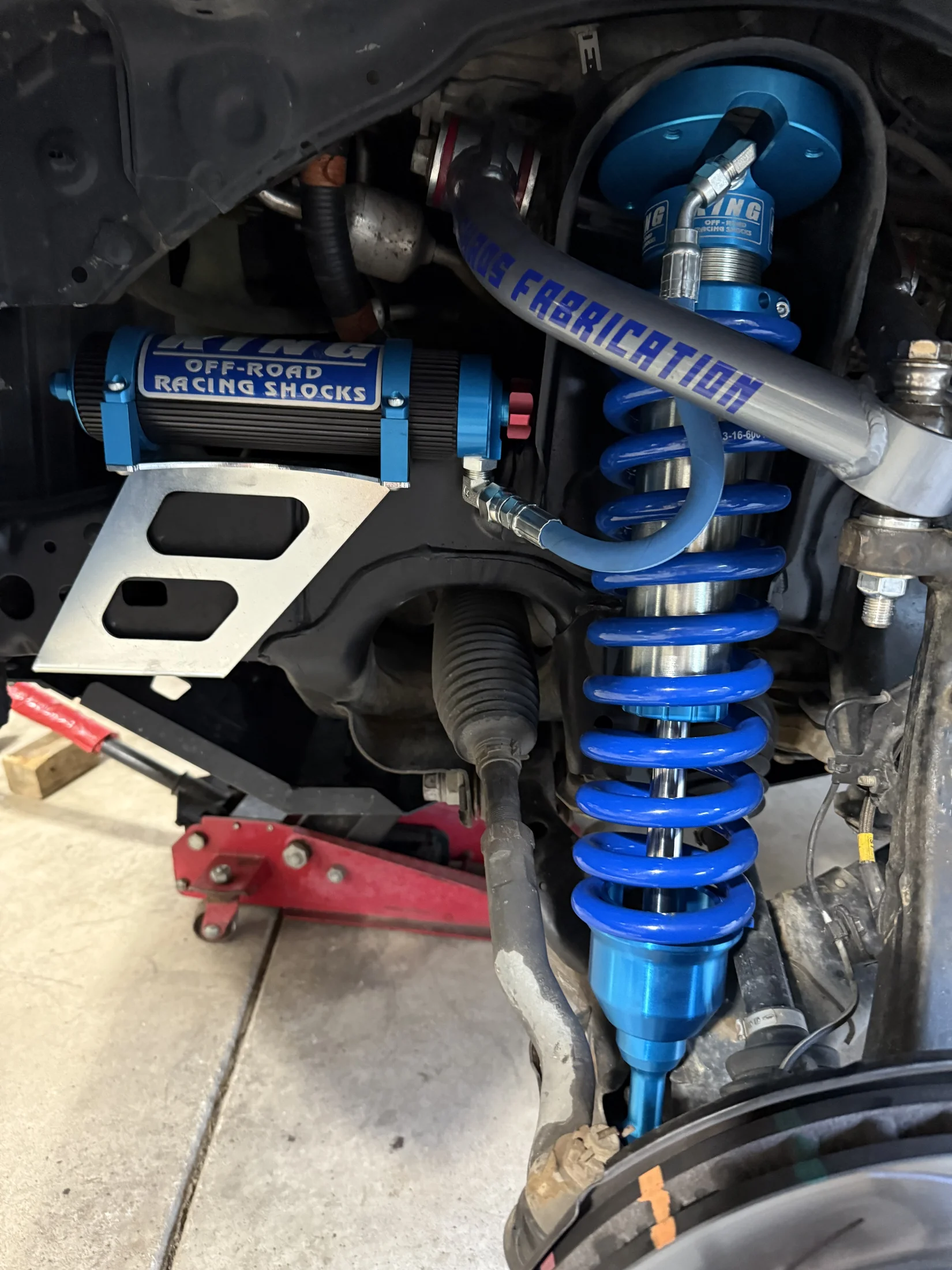

I’m doing King in the rear with the single compression adjustment. I prefer this on mountain bike suspension - the more complex stuff is hard to get and keep dialed in and King has full DIY service support. I looked into Dobinsons, but felt King was the longer term self service future proof route pairing with the Elka front. The lesson here for me - and I was wary of adding complexity at the outset - is maintenance costs will exceed a high purchase price over time if you can’t service it yourself.
