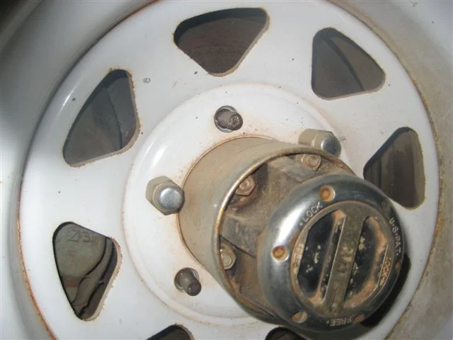

You may consider using an open-ended push-through center cap. The ones I have make it impossible remove the hub bolts without first removing the tire.
Do you have an image of that? I could fabricate something down here.
Certainly...I hope this works. The body of the locking hub assembly cannot be removed without wheel/tire removal. The hub's cap ass'y, however, is still exposed, and could "grow legs" and walk away without your permission.
Regards,
Bill

interesting but actually I was referring to the caps of the locking system. The actual hubs would be very difficult to remove especially with those conical washers... :-)

Coen,
On how to protect your hubs - I have the same shields that Bill68340 has, but then you put putty in the allen heads on the actual hub. You can pick it out with a small pick when you need to do maintenance, but they are a PITA to do on the fly, so your typical thief bypasses them.

Coen,

Thats a great idea!
Regards,
Bill
This setup could still work all you would need to do is to extend the length of the cone and add a lip to hide the bolts.

Thank you for all the nice comments.. Greetings to Arnhem and contreien. Tonyfj45: I will look into this, but might want a cleaner solution. The allen thing might work for me...
