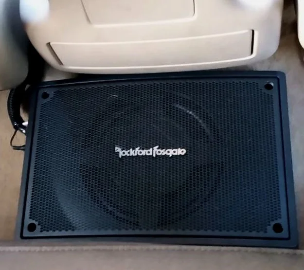

I might have one rear seat passenger once a year. I love the sound and location. It was just to0 tall to mount under the passenger seat. I think it worked out for the best.
I don't need to turn the punch volume control more than 1/2 to 3/4 of the way up. In this arrangement, I have the subwoofer in the center between 4 Fosgate door speakers and the factory tweeters. We did install a component to lower the tweeter volume since the door speakers run straight from the Fosgate amp.

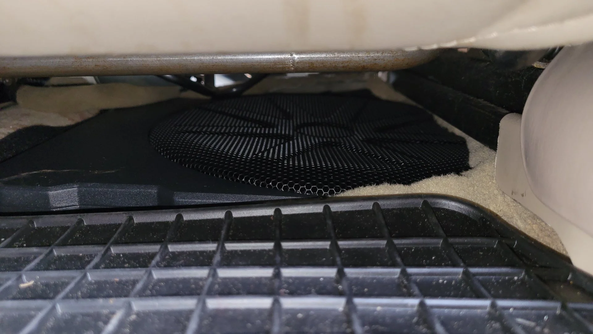

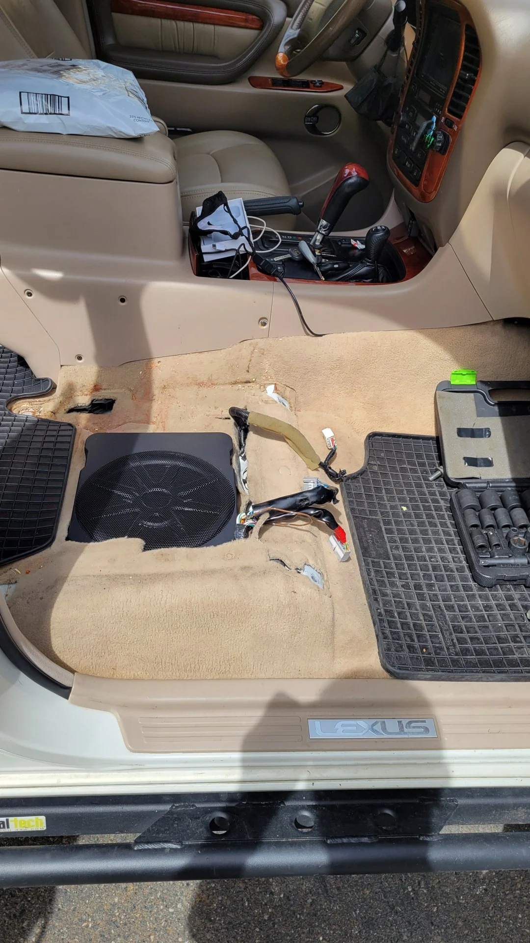

For those that are interested.. when I removed my amp there is quite a bit of room. I'd say approximately 16x9x3.5.. give or take. Larger opening is towards the door under the carpet you see below.

Figure I'll just keep adding to this thread to help others. I ended up fitting the Kicker HS10 under the passenger seat. Fits perfect... AND absolutely sounds incredible.
I'm blown away in comparison to my old Sound Ordinance underseat 8" sub. Granted this kicker is a 10" w/ 180 watts RMS, just sounds incredible. Anyone looking for a simple option with space savings., this is the way to go. Keep in mind., you must remove the factory amp under the seat.

I can't quite tell from the pictures but....It just fits in there or is there plenty of available room to shift it around in there?
There is probably another 3 or 4 inches of length to play with. Height wise it's a perfect fit. You could maybe go another half inch taller.
