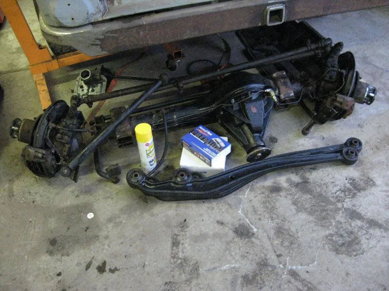

So I have a '91 Mini Truck that I am putting a FJ62 front axle underneath using coils. But what I'm getting at is for leaf spring cruisers...
I am not a tech crazy (to an extent) or even much of a coil spring guy in the traditional 4WD sense. For example 35" tires max for me on anything and I don't really have much desire to build a 3 or 4 link ever ("I know -we'll see about that") . The mini truck will be rockin' 33s. I've done all sorts of SOA variations, 60 axles (and even 80 axles) under a 40 or 55 or 60, and have built many a SOA as low as possible which as far as I'm concerned is the correct way to do it unless you are purposely building a monster. I know SOAs are tried and true and that is fine with me...
I don't mind leafs in the rear but am really growing to dislike them in the front. I have not had a lot of luck getting a front SOA to simply behave well on dirt and rutted roads, either too stiff or too soft or not enough weigh carrying ability. Seems like there is always a compromise. Plus I don't like the hieght range. I don't want big curve SUA leafs so I'm stuck with SOA. I feel that for wagons just a hair shorter about an inch or two is perfect height for a 55 or a 60 with 35's, otherwise they are just too big for my tastes (which is strong DDerable wagon that wheels very well, aka 35's).
I put a FZJ80 frame under my 55 project and have really grown to like the simplicity of radius arms (OEM FZJ80 style) with a track bar or panhard bar (different names for the same basic thing). I think I'm going to really like the range of use of coils and height control that just makes sense with 80 series under the 55. I'll use either FZJ80 springs or TJ springs as everyone makes TJ springs or possibly even OEM FZJ80 springs.
At first I figured it would be very labor intensive to do it as I'd have to fab up all the parts or be ordering from all over the place. I've seen Gumby (I believe) put a FZJ80 front axle/suspension under a 60 series. That is awesome and sort of what I'm driving at...
But I think there is a quicker easier way to get coils. And what I'm not understanding is why no one is doing it or why its not even standard practice now. As far as I'm concerned how I'm basically done with SOAs in the front and will only do coils now.
I was on pirate eons ago and found Ballistic Fabrication - Manufacturers of Precision Offroad Fabrication Supplies which is sort of a 1 stop shopping place for anything coil conversion. The first I've really liked or shopped at in all these years of 4x4 vendor this 4x4 vendor that on Pirate in particular. I'm still waiting for the parts to come (just finally ordered yesterday) but after pulling some 80 arms and doing all the measuring at least initially I have a killer parts list for integrating 80 arms onto a 60 axle under pretty much anything (40, 55, 60, whatever). I think it should work really well, behave and handle well, wheel awesome, and have all the performance I want. Plus you can control ride height fairly easily using adjustable coil spring buckets. Parts for everything came out to about $400 shipped from them. I can use the TJ springs or 80 springs or whatver...
I haven't done the work yet but I'm not imagining it being overly hard. I think the hardest part will be the mockup related to removing the old IFS stuff on the mini truck. It won't be a blank slate so easily like a cruiser frame can be with 30 minutes and a torch... (It'll be more like 1-2 hours, LOL)...
Am I barking up the wrong tree here? For only $300-$400 more or even $500 more making your own radius arms from scratch I don't see why everyone isn't doing it. I don't think it'll be any particularly harder than say a SOA with a shackle reversal...
Thoughts??!

Ballistic Fab coil spring buckets/shock mounts/radius arm mounts (one piece)
In place on something American like a Heep:
Ballistic Adjustable Coil Spring Buckets:
