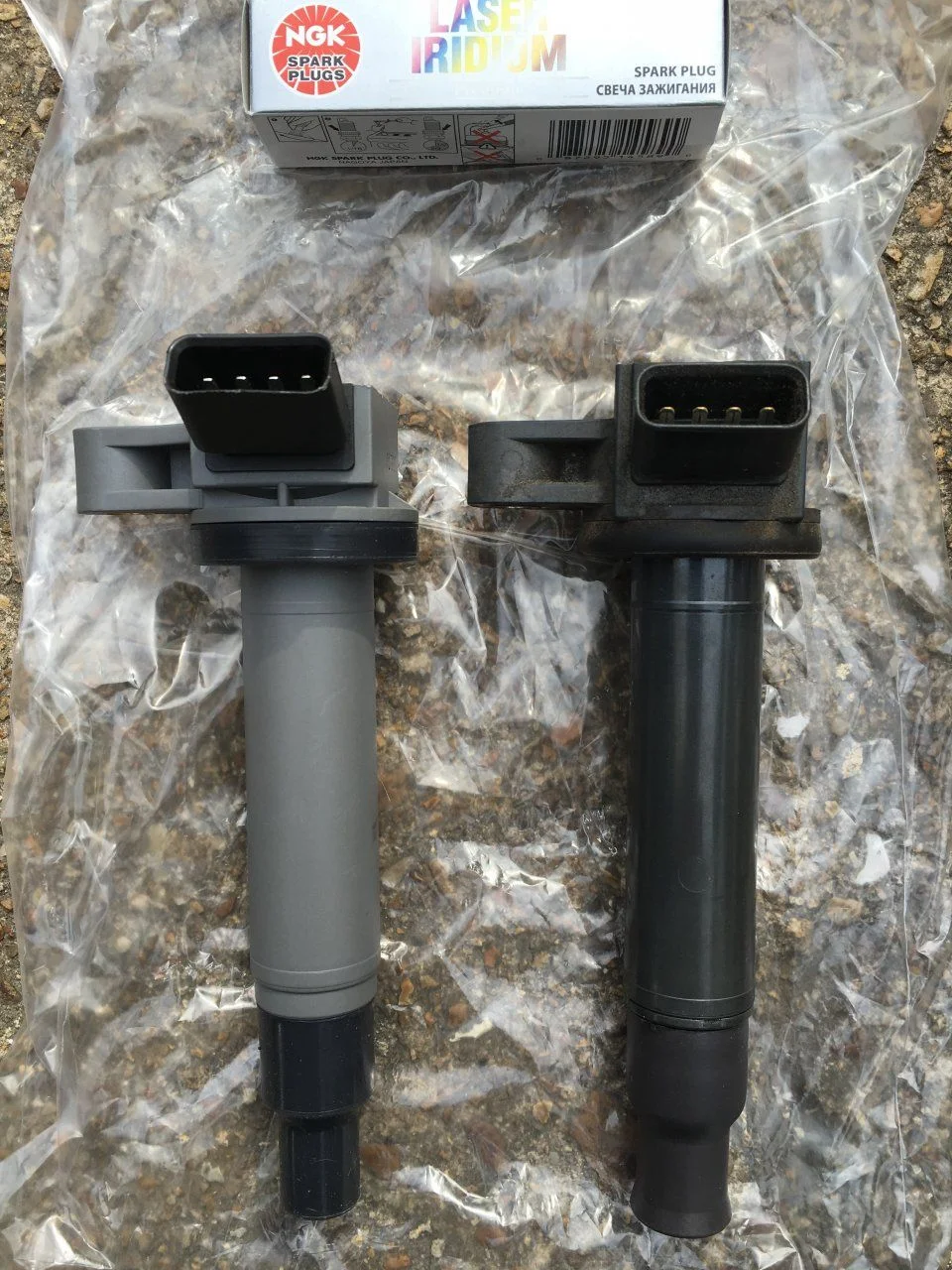

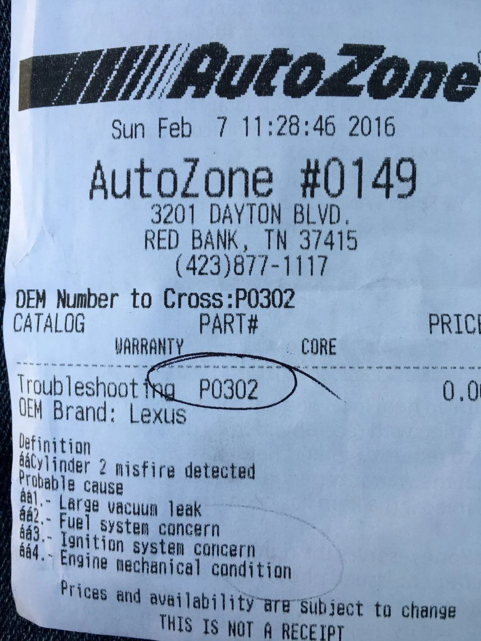

Been reading thru the treads on coil pack replacement. What I haven't seen yet is if it's possible to statically check resistance of the pack? There are 4 terminals on the plug connection. I've tested resistance between pins 1-3 & 1-4 (left to right 1-4). Each showing between 24.5~27.0 k ohm
Just replaced #2 pack today. Easy job, Oreillys auto $83. Now just need to hook up OBD & clear the CEL. Thx for thread info! Cheers
