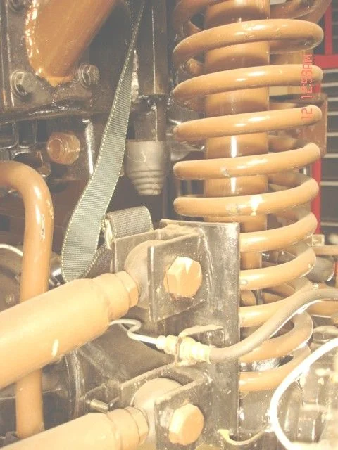

It's tight, but it can be done. The only rubbing I have is on my sway bar slightly touching my Y-LINK bars. I still need to cut it down a few inches. I'm extremely satisfied with the conversion. Tie rod is prebent (to clear pitman arm swing) 1 1/2" 1/4" wall DOM. I'm using 4" TJ coils/ 1 3/4" 1/4 wall DOM & 3/4" cromo rod ends:
Your track bar is going the wrong way
Unless you wanna crawl under my rig & see if there's any other way to mount it, I'm all open to suggestions. On road or off it preforms really well as is - barely any side to side movement until you let the limit straps go.....

he bent the Tie rod for clearance, not as an aftereffect of hitting a rock ;)
I have a bent 1.5" .250 wall dom one that was not intentional ;)
Thats what I figured... just thought i would ask. Seemed too obvious to be worth mentioning if it wasn't "special"...
:doh:
Bent 1.5" .25 wall tie rods hold up? I'm kinda suprised...
You ever held a piece of 1/4" wall & compare it to a stock & straight tie rod? ;p I have full confidence the knuckles will desentigrate before that tie rod bends by any force my steering can throw at it. It's either that or full hydro & there's NO WAY I'd ever do full hydro on those small pattern knuckles :eek: I have a fully plated set of knuckles I'm throwing on before GSMTR ;)
I have 1.5x.25" Tie and relay rods ;) I made them after I snapped a stock tie rod.
know it's heavy stuff, but I've watched friends bend it on the trail.

What sized tires & steering setups were your friends trucks running? Are they DOM? I still say I will not bend mine due to steering forces ;p Warpage on cast knuckles? All I added was some 1/4" plate welded intermittently, not all at one time. I brought them to one of past meetings, I guess you weren't there:
