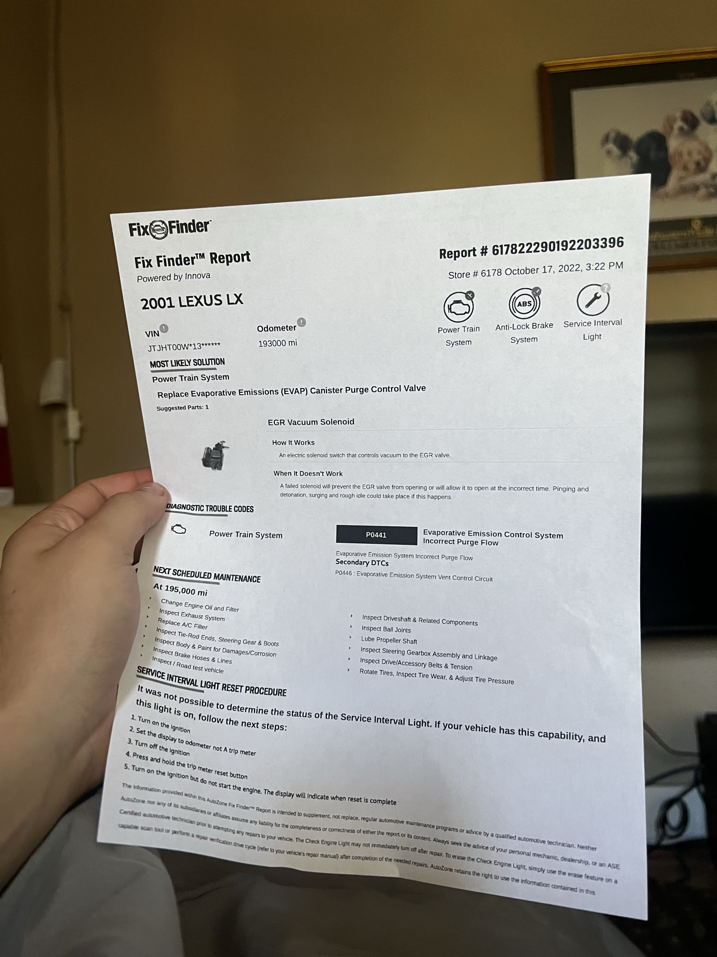

I just finished replacing my alternator brushes and fixing a valve gasket leak and now I am receiving check engine light code P0441. The report came back and states that the most likely solution is to replace EGR Vacuum Solenoid. I saw from reading other discussions with the same code that it could be many different reasons such as replacing the gas cap? Should I go ahead and replace the Solenoid like the report said or should I try something else first?
This codes are pretty diverse. I would start with the easiest/cheapest to hardest/expensive. I would change the gas cap and see 1st.

Another possibility is that there is a leak of your evap system. For that you could get a diy smoke system to figure out where you may have a leak and fix that.
With 193k miles evap issues start popping up at this time due to vacuum tubing getting older.

Chiming in here as I found this thread when doing my initial search on the 0441 code. The new gas caps have a defect. They all have too much play in them, and this is a common manufacturing defect that has been mentioned in other forums.
The vacuum valve assembly was $65 and fixed the problem for me.
