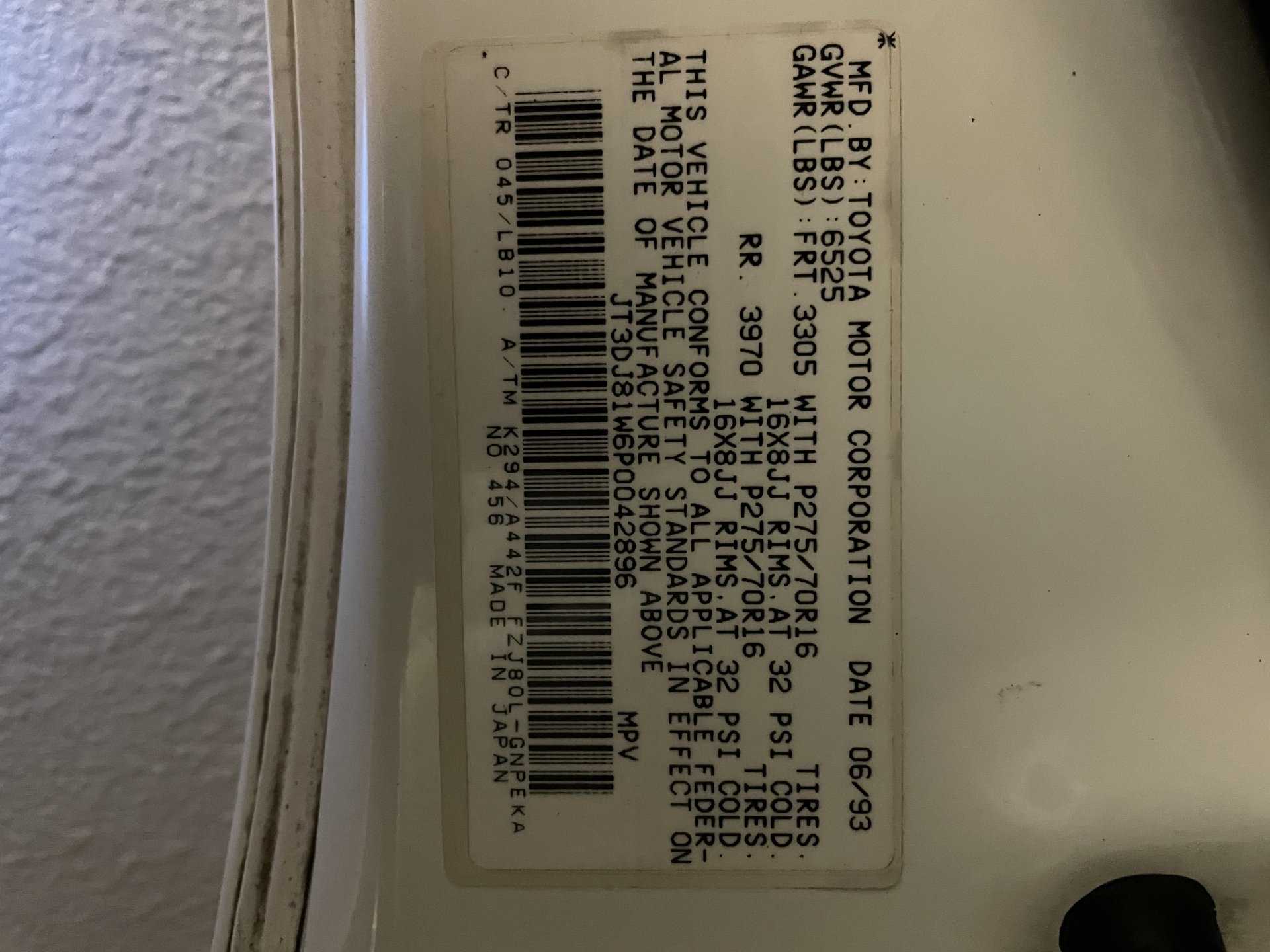

I have a 93 with 180,000 miles and a 60220 ECU that just started throwing 83 84 85 intermittently. Based on this thread and others, the simple and maybe only solution is to buy a 60221 but before I do I have two questions I’m hoping y’all can help me out with:
1) it’s a California truck so I recently jumpered the EGR temp sensor to rid myself of a 71 CEL, which worked, but maybe not so coincidentally, I got the 83, 84 and 85 same day. That said, Land cruiser specialist had my truck a week before and said they had read a few transmission codes but I forgot which codes they mentioned so I’m going to call them Monday to see if they were seeing 83 84 and 85. If they were, that debunks my suspicion that my jumper job may have influenced these codes. Do y’all think the jumper could have contributed to these codes?
2) @cruiserdan my truck was a California truck made in June of 93 and the vin ends in 42896. Based on your comment regarding the dates of ECU, shouldn’t my truck have a 60221? I was surprised to see a 60220. See pics.

There could easily be some leeway during the trasition, or the switchover date in the catalog could be incorrect.
In any event your fix will be a 60221, if you can locate a used one. I know of one but it will not be cheap.
