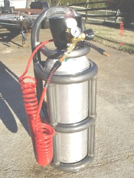

The design calls for using 1" nylon tie-down straps to secure the bottle. I punched the oval holes for the straps:
Then added some round stock to support the corner bends and provide a smooth surface for the straps to be threaded through. This will prevent the straps from running over a sharp edge and being damaged over time:
I don't have a roller at the shop so the cradles for the bottle were hand formed in a vice using a piece of pipe:

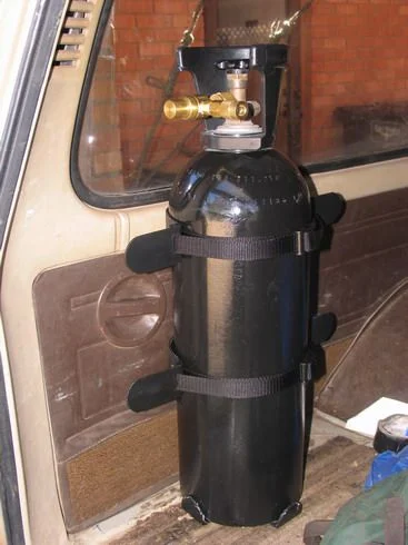

Test fit:
The bracket will be mounted to a metal support behind the kick panel:
The bottle can be safely carried and used to inflate tires and run air tools on the trail. The wings on the cradles will be used to hold the 25' air hose:

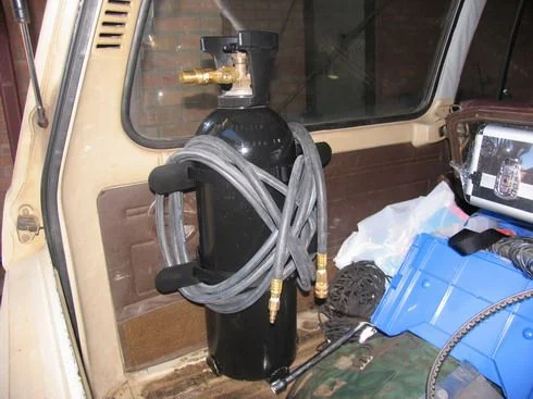

I got the tank installed.
Big kudos to Tom on a job well done.
Very secure and no rattles. The hose coils easily and doesn't tangle.
Sparrow is ready for the Round Up in March.
Happy Trails! N
