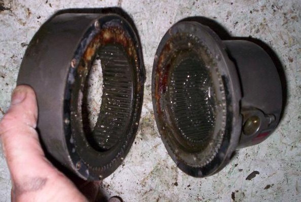

I have a Warn M8000 that I am getting ready to refurbish and mount on my 80. The clutch lever is stuck on the "engaged" side and i can't get it to budge. The winch is in really great shape, almost like new, and i haven't torn it apart to see what it needs.
Does anyone here know what might be wrong or have had this happen before?

The tolerances on the sliding clutch ring (for lack of the proper term) are pretty tight. If it has been inundated or wrongly lubricated, it will bind. Follow this link on how to rebuild it. It's pretty straightforward.
Rebuild info: Warn M8000 Winch Breakdown - Four Wheeler Magazine
More info with troubleshooting: Troubleshooting Warn winches - FAQ - JeepForum.com
I bet yours will look like this inside:
