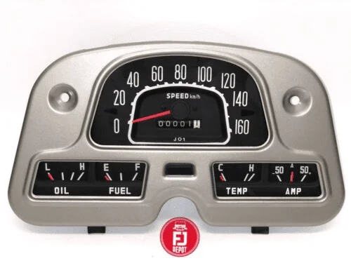

Does anyone know if a 3rd gen cluster will work in a 1984 hj47? My cluster is in a horrible state and figured why not just purchase a new one. I can only find 3rd gen clusters and wouldn't mind using one as long as I know it will work same way.

pop your old one out before pulling the trigger. i have a 79 43 and just bought part number ending in 60180 (says it works based on the year). Only to have it need a 60014. Trying to see if there is an adapter or some fix to make the 60180 work, but haven’t turned anything up yet.
