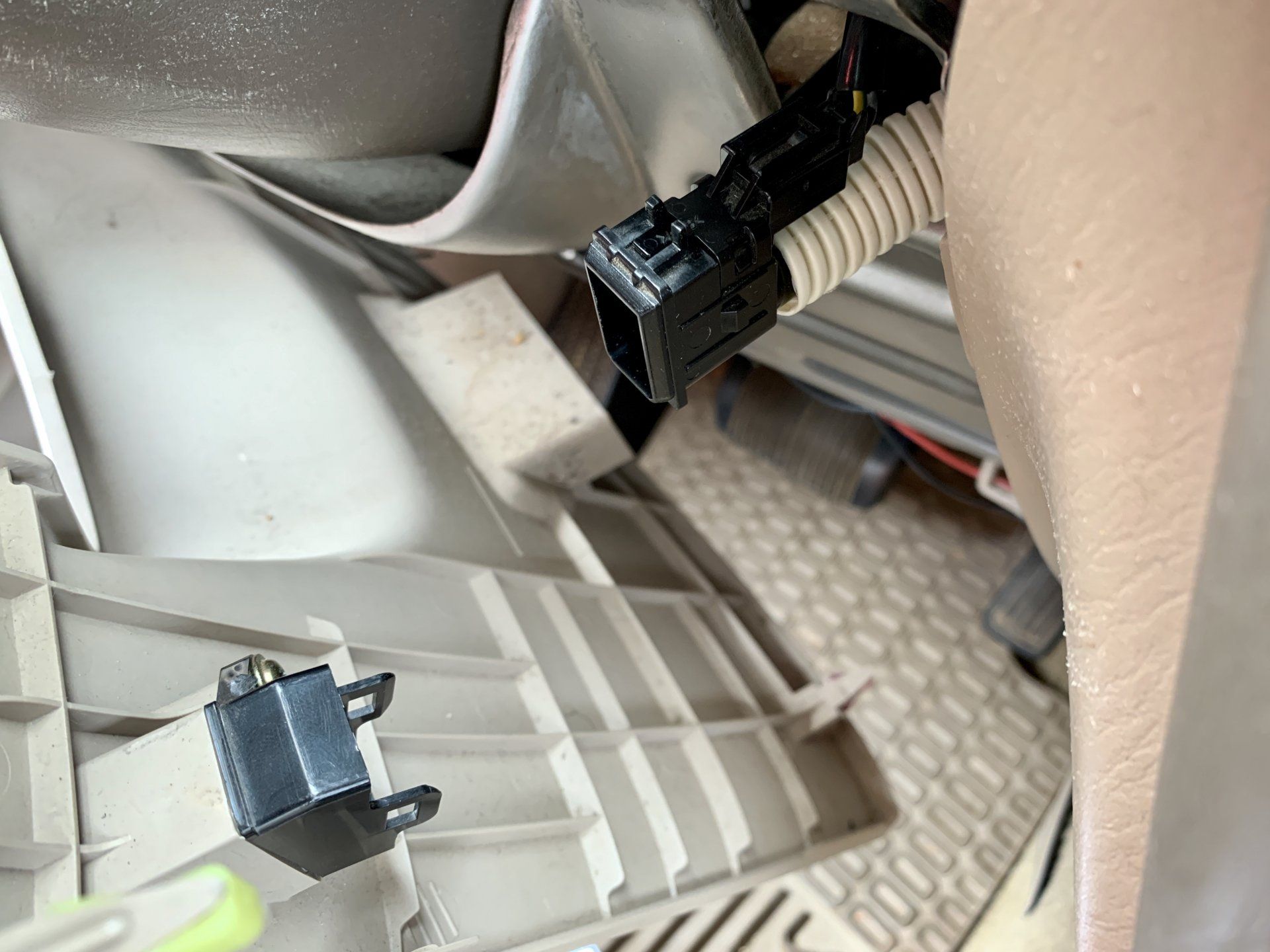

I just got a 99 lx470. My climate control doesn't seem to work right. The ac will work if the temperature is set all the way down to cold. If the temperature is set one click up, it wants to put the heat all the way up and direct to to feet. It can be 100 degrees out.
Does this sound like the interior temperature sensor? Is there abutting else it could be?
This exact same thing happened to me last week. To blow cold it had to be on the lowest setting, and one click up would be full heat. Come to find out this little intake hose was disconnected from the cabin temp sensor directly below the ignition cylinder. It’s an easy check and fix for you to try first

Along the top yes just clips. I think there’s a single screw in the bottom left corner below the gas/hood release latches, but you shouldn’t even need to remove it to access that area. Just pull the black trim piece below the gauges towards you, then get some trim removal tools or your fingers and gently pull the right side of the trim piece out starting near the ignition cylinder

I tried this, cleaned the sensor with a MAF cleaner, disconnected battery for 15 min and it still does not function right. My LX470 just turned 72k miles but I know things get old, even if not used much. Do I need to buy a new sensor or is there something else to clean?? If it is a new sensor, what is the part number??
You may have just saved me! Can’t wait to check in the morning.
