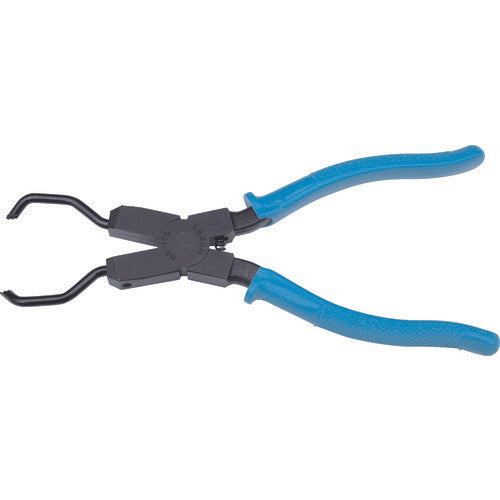

I was able to pull apart the dash to get to it after unplugging all the small things above like antenna and rear glass heater, cannot for the life of me unplug the back wires even when pressing in the clip on the side i’m terrified of yanking those is there a trick i’m missing?

You're missing Merry Tools HS175C
Seriously, with my ham fists and sausage fingers, these things are a godsend for any of those hard to reach multi-pin connectors. You can grab the connector right on the release tab, squeeze, give it a bit of a wiggle and it comes right apart.
