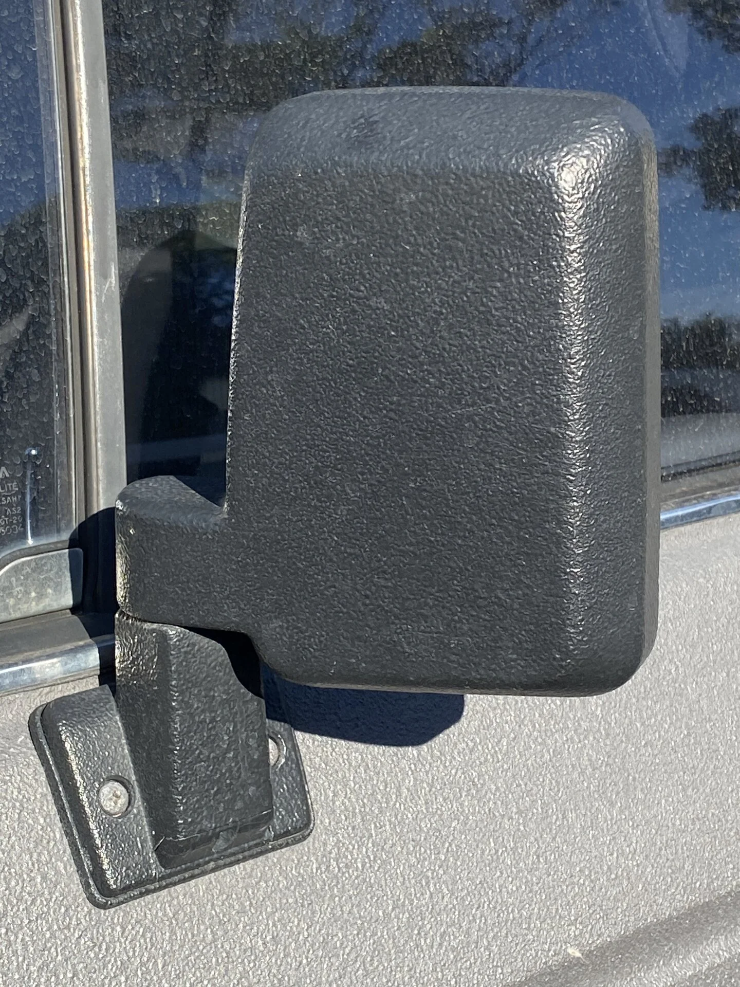

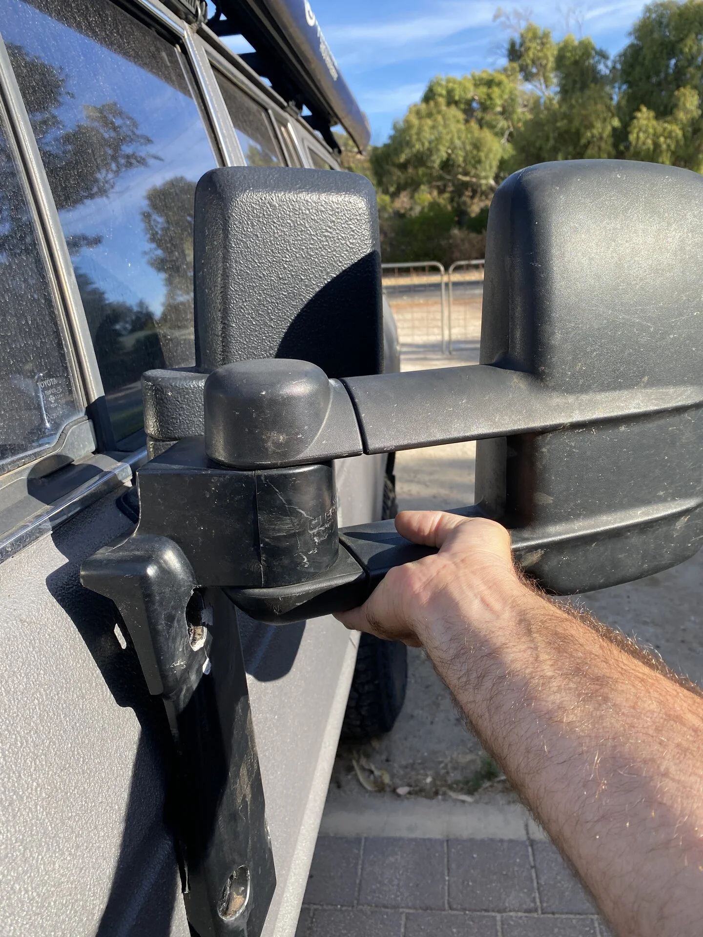

So far, I have had a look on YouTube and studied how to take a Clearview mirror apart.. I have held it up against the car and seen that the top 2 mounting bolts / screws match up with the factory mirror mounting points, the shape of the mount is wrong - but not too bad that a cutting disc / grinder / flap disc can’t fix. The lower half or 3/4 of the door mount will be cut off…
I have taken a few photos this afternoon (attached) and think I will shape the top of the mount to suit the door shape, and cut the door mount off even with the top of indent in the door… I will then drill a couple of screws / bolts to go through the lower part of the mount and the door, with steel backing inside the outer door skin….
The Clearview mirrors stick out WAY too far for what I need, and for what I think looks good… I am intending on cutting them back as close to the door as I can (making them non - adjustable if needed) - they will still stick out at least 100mm (4 inches??) either side of what the factory mirrors currently do due to the mounts, but this is about right for what I need…

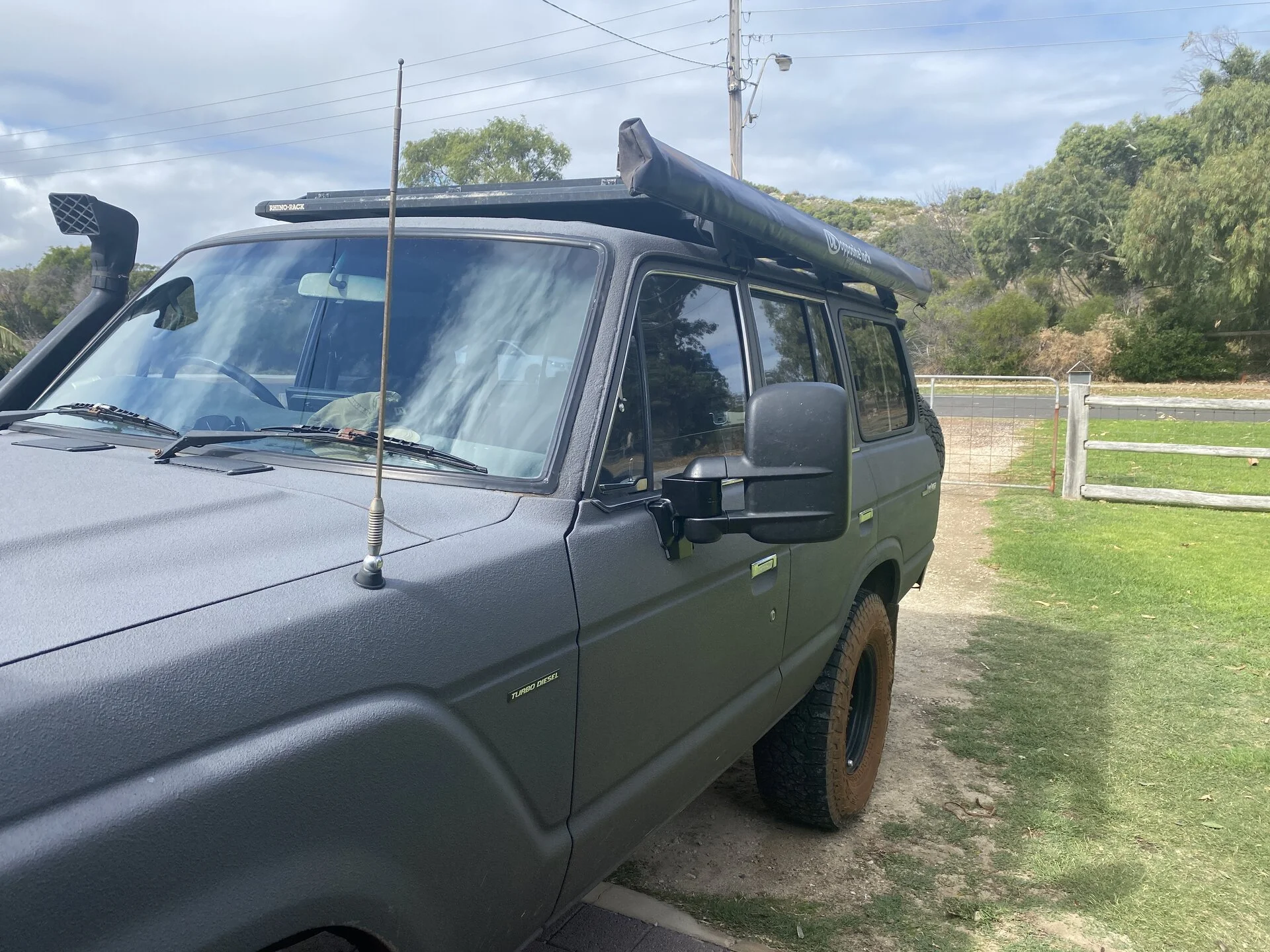

Sorted… I cut about 3/4 of the door bracket off and used a flap disc to change the angle of the bracket where it meets the door to square the mirrors up, and shortened the arms by 80mm so it doesn’t look too much like a Wing-Nut… they still have 30mm of extension. In their narrowest position they sit a full factory mirror width further out from the car. The bottom mirror (convex) section is great for filling in blind spots when driving!
