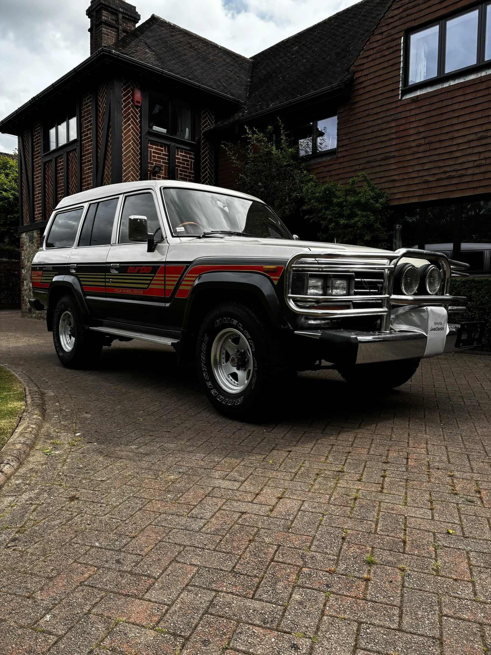

Hi can I have some wisdom please, just taken delivery of my first HJ61 from Japan with 190,000kms and she is in really nice condition but she is a little smokey. I thought it’s might be she was in an auction and then on a boat so I let her run for a couple of hours on tick over but it made no difference.
What’s odd that I have never seen is the oil is clear, not golden but clear. Could it be the issue? Or is that wishful thinking?

It is a little harder to troubleshoot these types of issues without being able to drive it for a while. To assess if it is consuming any oil, using a little more fuel than it should, etc. Looks like a decent unit, and probably just needs a little TLC to get it tip top. :cheers:
