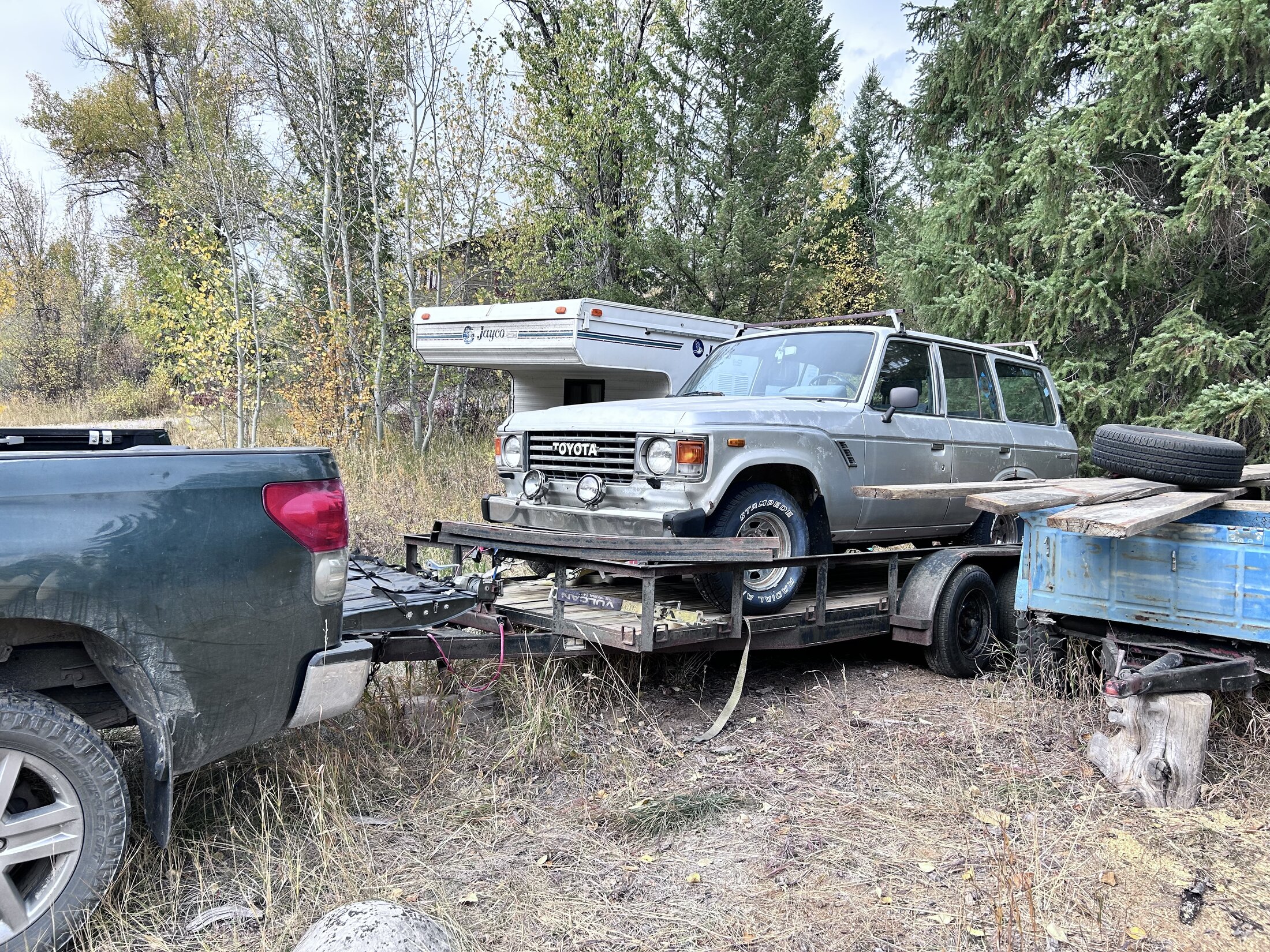

Like all good impulse buys, I bought two landcruisers. @wdukes sold me a donor fj60 to accompany the unicorn. The wagon
suffers from frame rot, so it’s a donor.

So thank you Dukes for feeding the addiction. My wife has a different sentiment on the 60, so that may need to get stripped sooner than later.
