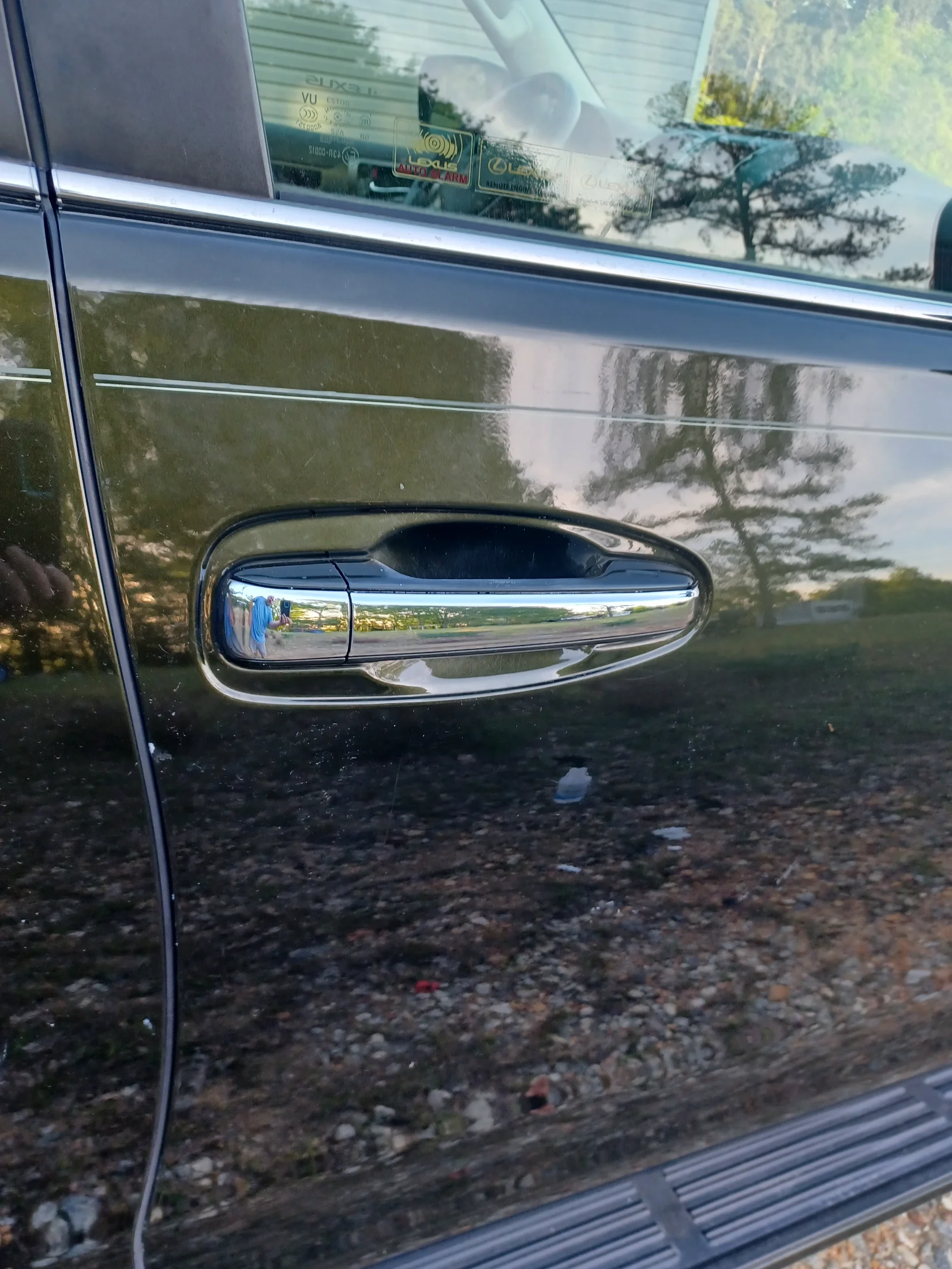

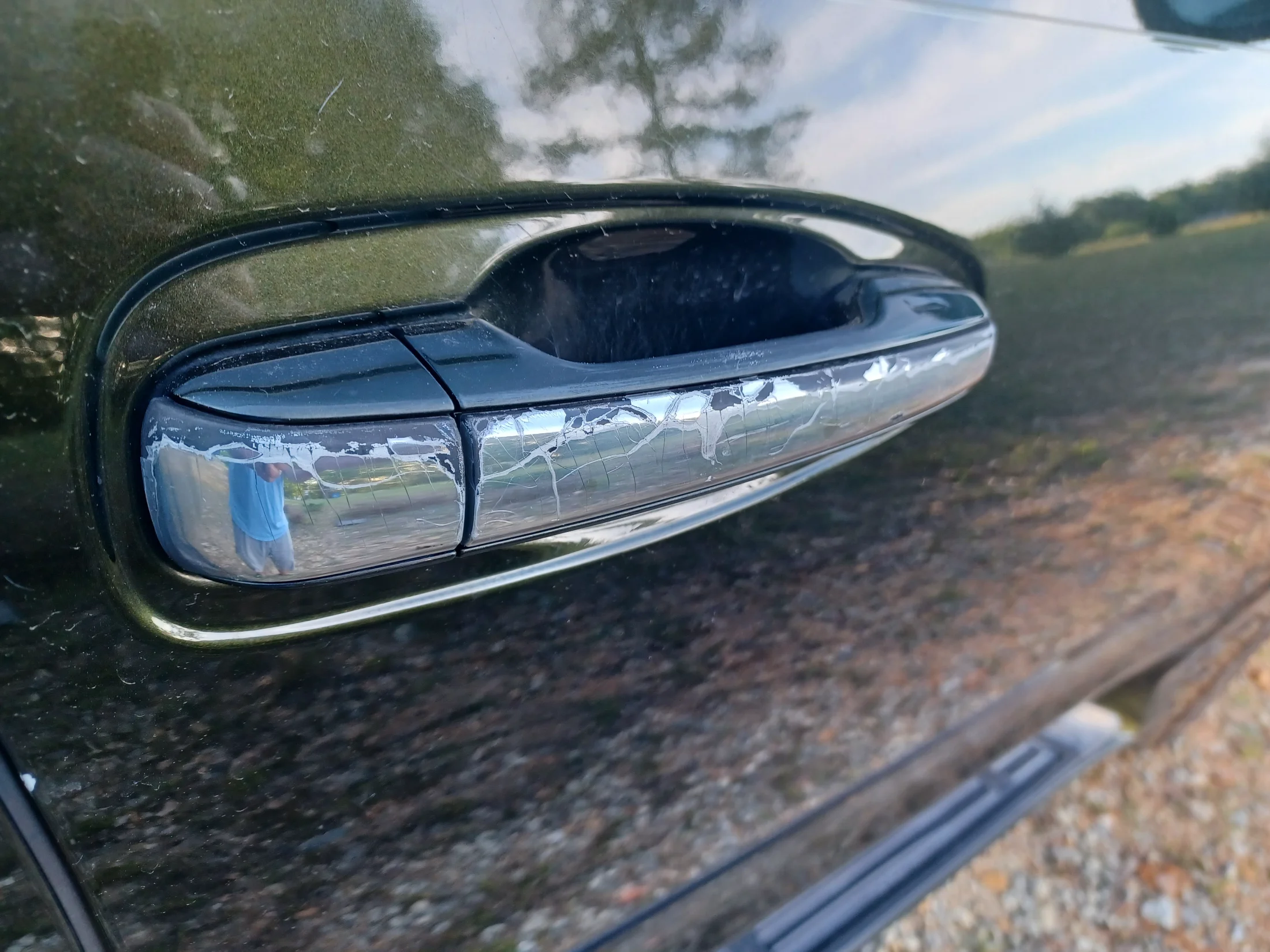

My door handles are exactly the same as your before look!
I'd love to do mine. What/how did you do yours?

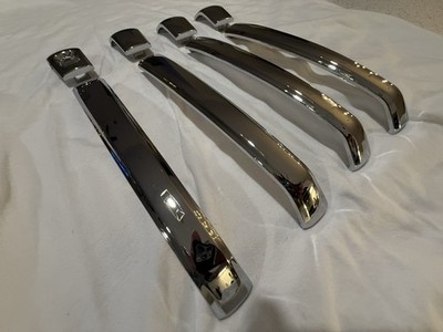

Just got some cheap ebay replacements. Will edit with a link. Oem is just double sided taped on btw.

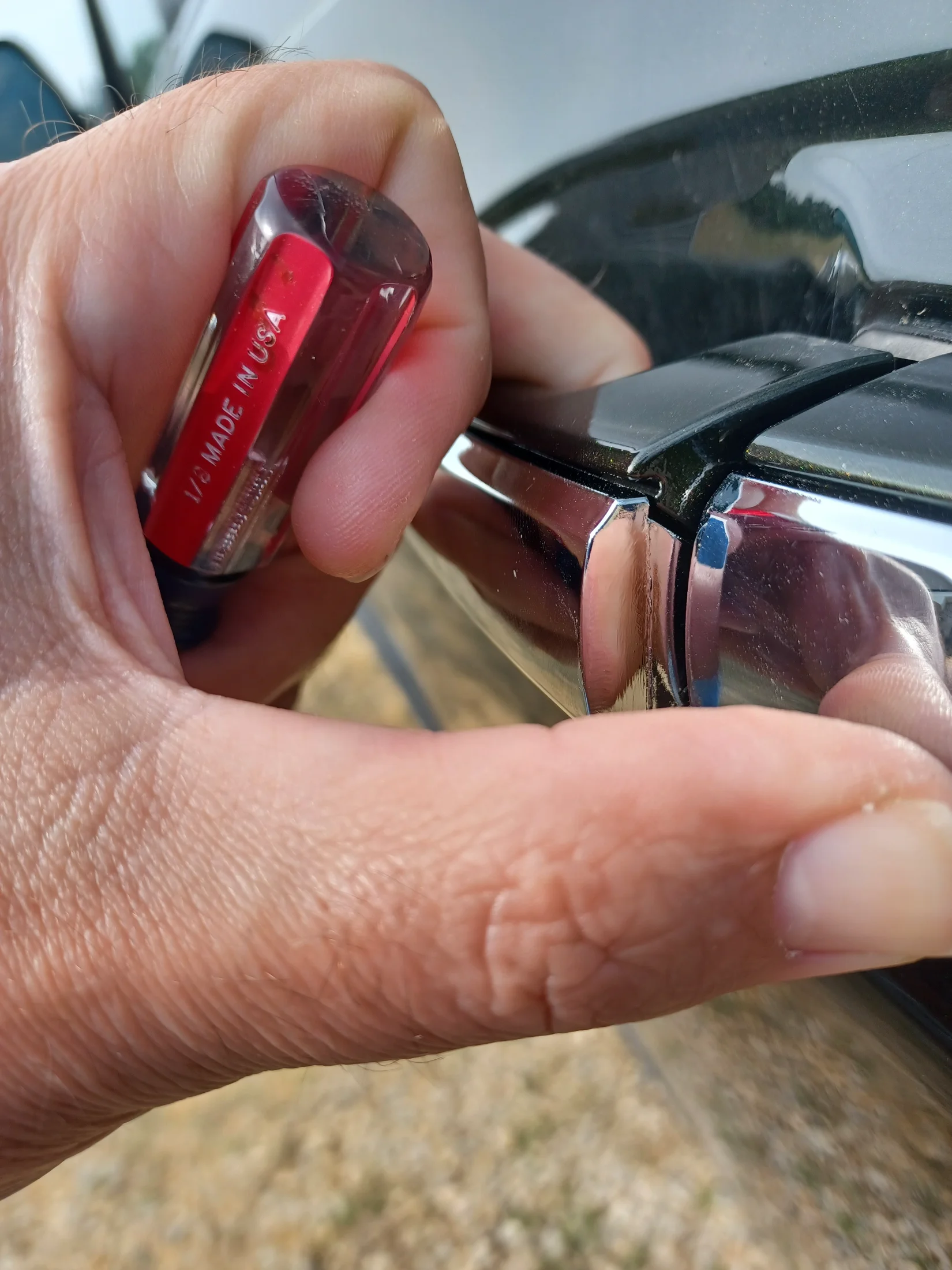

I used a sturdy small flathead screwdriver to get under the edge.

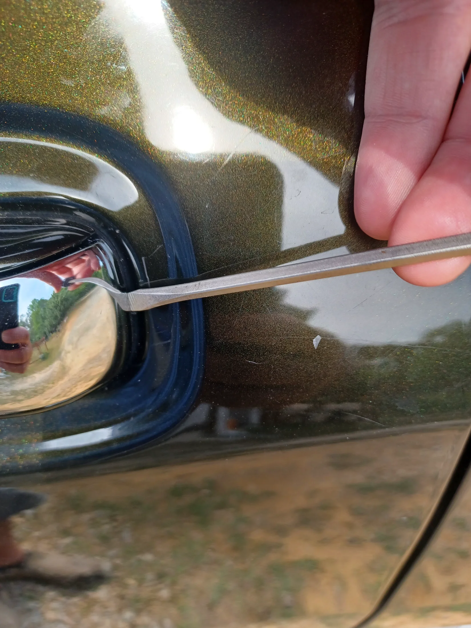

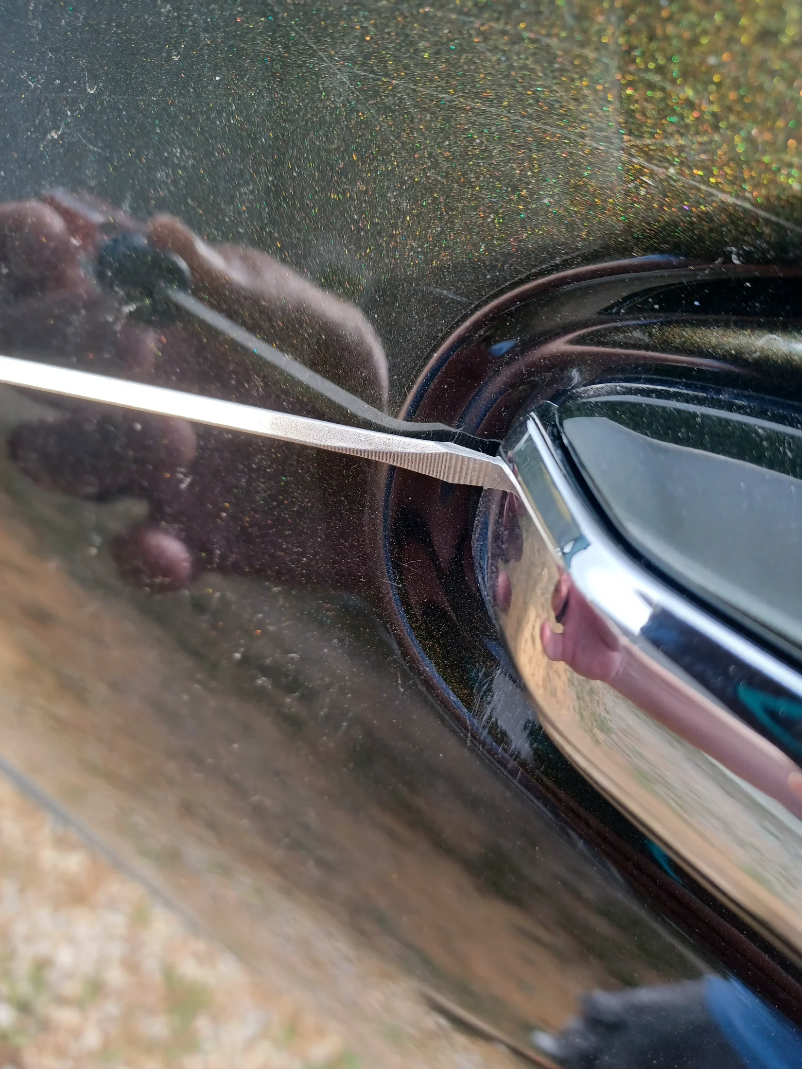

Carefully pry in the locations in the pictures so you don't scratch your paint. Once I got it started coming off I would get a little more aggressive with the screwdriver going under the trim piece. Remember the handle is just painted plastic so if you do a little damage it will be covered back up with the new trim and won't rust. Make sure you dont wedge from the top or bottom though as that may leave a permanent mark that wont get covered up. My trim broke in several pieces as I removed them, very brittle. The handle itself had little to no damage. You could probably pull it away with a pick tool or similar if you're nervous about using a screwdriver to start it.
In the last photo you can see another location you could start from. Had to get one trim off by wedging the blade in the gap you see between the trim and handle that makes a "\_/" shape. Pulled the handle and kept my knee against the door to get access.

Most everything on eBay looks like a full handle replacement, not just the chrome cover.
I put the link to the seller I bought them from a few posts up. Post #10
