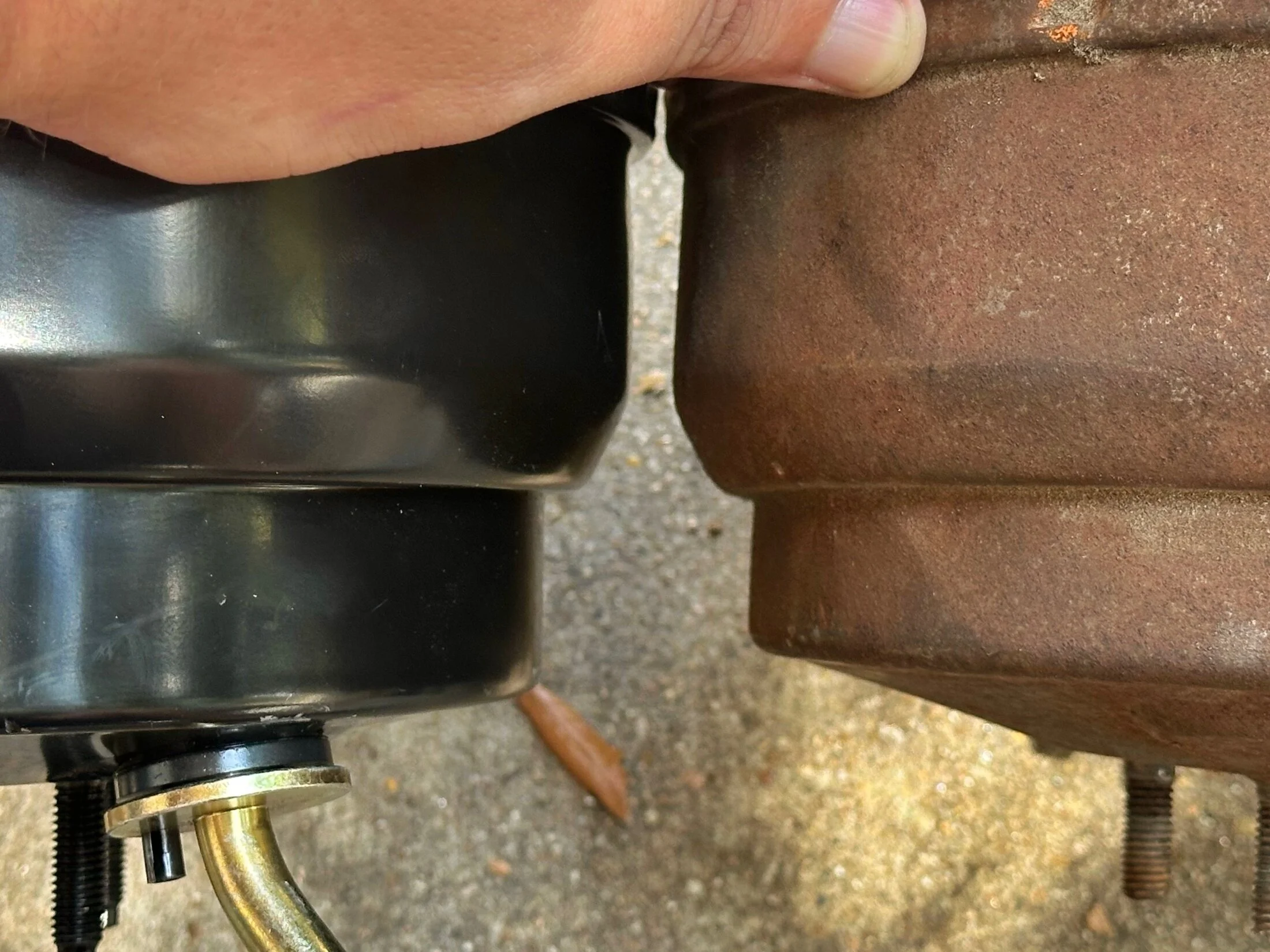

Having a hell of a time getting the City Racer brake booster to go on ('94). The stock one had JUST enough clearance to wiggle past the intake manifold on the way out. Looking closer at the City Racer it has a slightly different shape that puts the shoulder that interferes with the intake mani even more in the way than stock. I've had it in and out 10 times so far and not getting any closer. I'm starting to think this thing isn't going in.
Anyone else run into this? Obviously these have successfully been installed before. Wondering if they changed design.

It doesn't really matter if the booster profile has changed, does it? You have it in hand and have to get it in. Unless you're going to send it back, I mean.

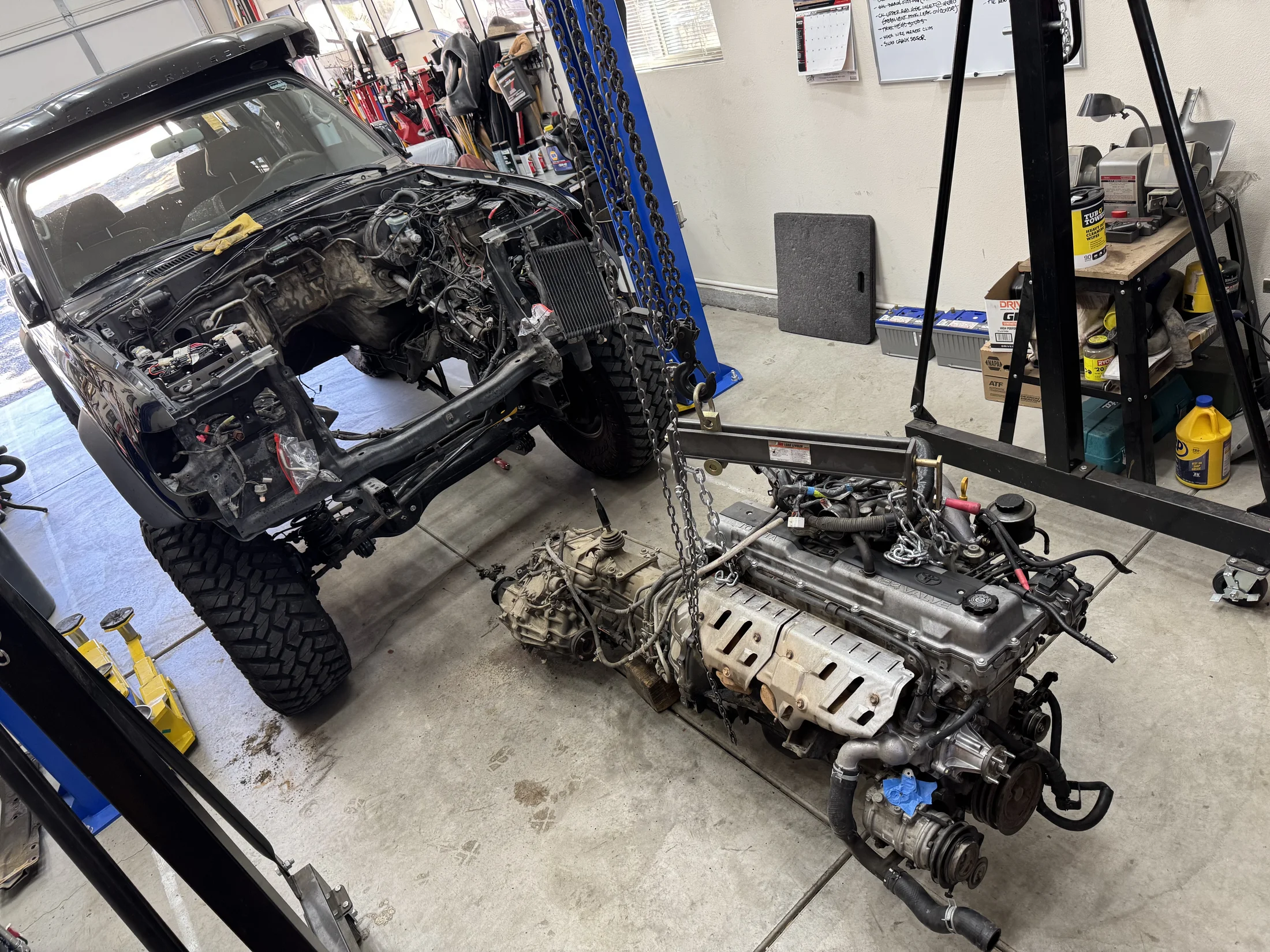

Job done. A few final thoughts for future reference.
- Just jack up the engine. Don't waste your time trying to avoid it. 17mm, undo both sides as far as you can without taking the nut off, raise the driver's side up.
- Unbolt your power steering reservoir before you jack the engine up. I put too much tension on my line and created a leak.
- Don't mess with removing the clevis. The clearance you need is to the manifold. I didn't find the clevis to make a difference in that. Getting the clevis back on with the booster installed was a pain.

Replaced mine last year with a Seiken and deleted the ABS and LSPV at the same time, it was a tight mother getting the old one out and new one in. Seems like there was a certain way I wiggled on it where it suddenly went in, I used a friend on the inside of the firewall to help guide it in and we finally got it. We didn't have to mess with the engine mounts.
