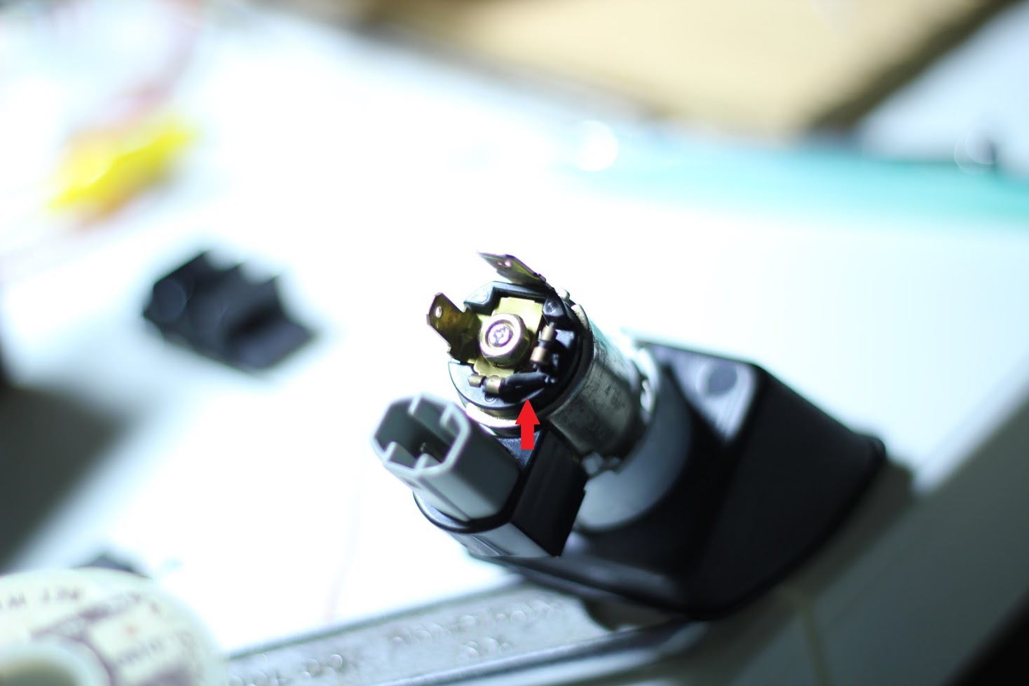

When I first got my 80, the cigarette lighter didn't work. This was the problem. I just deleted the fusible link and replaced it with a small piece of copper wire. I'll see if I have any pictures.
Edit: Found a picture. This is of the back of the lighter assembly removed from the dash. The arrow points to the short segment of wire that I had to replace.

The link on the back of the lighter was the culprit. I tried shortening it and then just removing the disc but it just kept blowing fuses. Since I never use if for anything other than USB chargers I decided to just make it a permanent mod.
